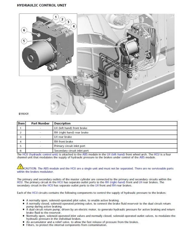

Has it bled sucessfully - fluid with no air ejected from each of the bleed screws (and especially the front where the hose issue started) under pedal pressure? If so, you should have a normal brake pedal action with the engine running to build up and maintain vacuum assist. If it's spongy, there's still air in the system and it needs bleeding starting with the rear RH (your passenger side).
If you can't bleed an individual caliper or one side, the most likely culprit is the HCU/ABS unit having stuck or failed solenoid(s). It's the only component deliberately designed to restrict fluid flow in the braking system.
Graham - where are you getting those nice pics from - I checked 4.2 and 5.0 manuals in the stickies, nothing like the one you posted.
I bought one day TOPIx time and downloaded the Workshop Manuals for my X150 and F-Pace.
https://topix.jaguar.jlrext.com/topi...cle/lookupForm
JLR used to provide the each of the Workshop Manuals as a single PDF but for some time now they have been in individual sections to discourage anyone downloading the whole thing and distributing or selling them as was happening with the likes of JagDocs. It was around 2000 separate PDF's for the two Workshop Manual's so it demands extreme persistence to copy.
