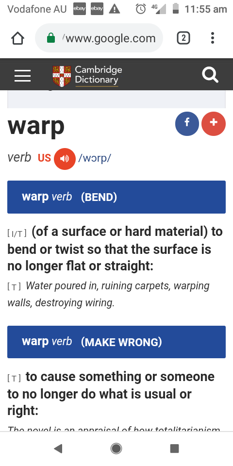

Originally Posted by Stuart S
I'm not cynical, just realistic. My rotors aren't warped, but my sense of humor is. Accept that you were mistaken and move on. You learn something new every day.
Why don't you look at the definition of warped Stuart .
Stuart have you ever turned a single spanner in your life I very much doubt it
