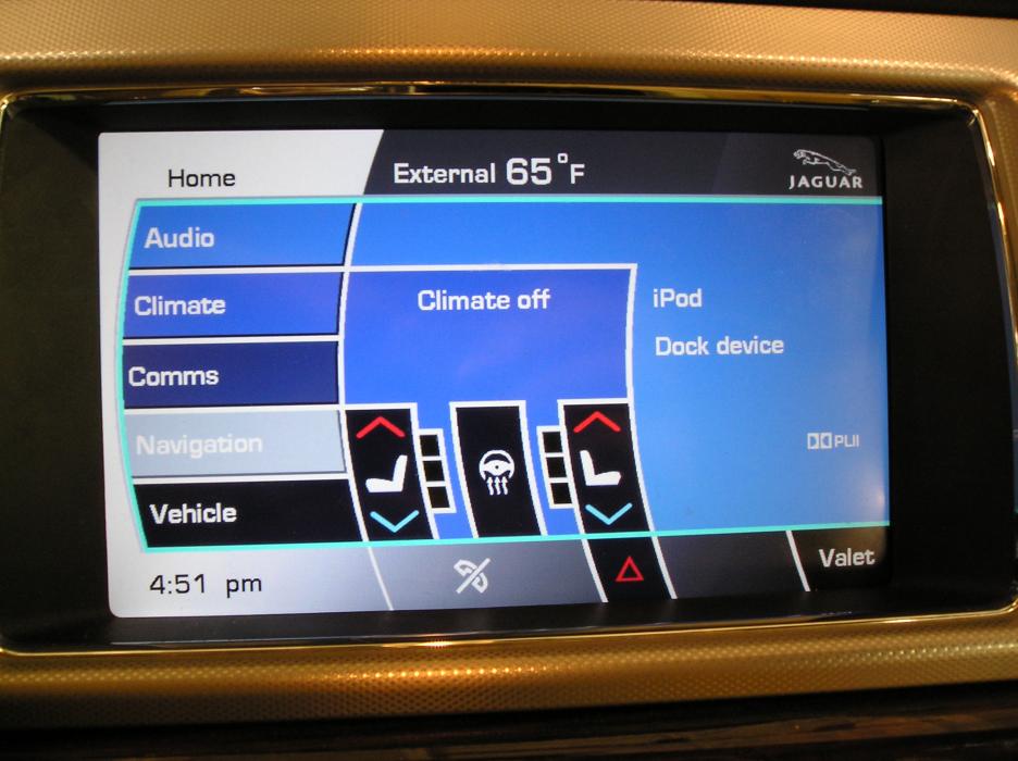

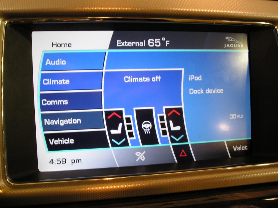

Let's give this a try and see if we get anywhere. Put a battery charger on it first to make sure we don't have any voltage problems.
Do these things in exactly this order.
Turn the ignition on, go to the home screen and select Navigation. Stop at the caution screen and don't acknowledge with the Agree Button, just leave it on that screen.
Go to the NAV unit and insert the new NAV disc, and make sure you slide the switch back to Locked. Wait for the update screen as in picture labeled Step 1, press continue.
Here's where the difference comes in.
It may go to the logo screen for a few seconds and then seem to go back to the Home Screen. Check the Navigation button, I think it will be grayed out as in pic Step 2. Don't touch anything. Sit and wait.
After 8 or 9 minutes the Navigation button should come back, as in Step 3.
Key the car off for a couple of minutes and start her up. Access the Navigation and try it out, you should be good to go.
Try that and let us know how it goes.
Good luck!
Attached Thumbnails 07 XK nav system DVD-step-1.jpg   07 XK nav system DVD-step-2.jpg   07 XK nav system DVD-step-3.jpg

Default Worked like a charm...
New discs updated software - went smoothly.
While I did not get the screens that xjrguy has posted, it did update and worked fine.
