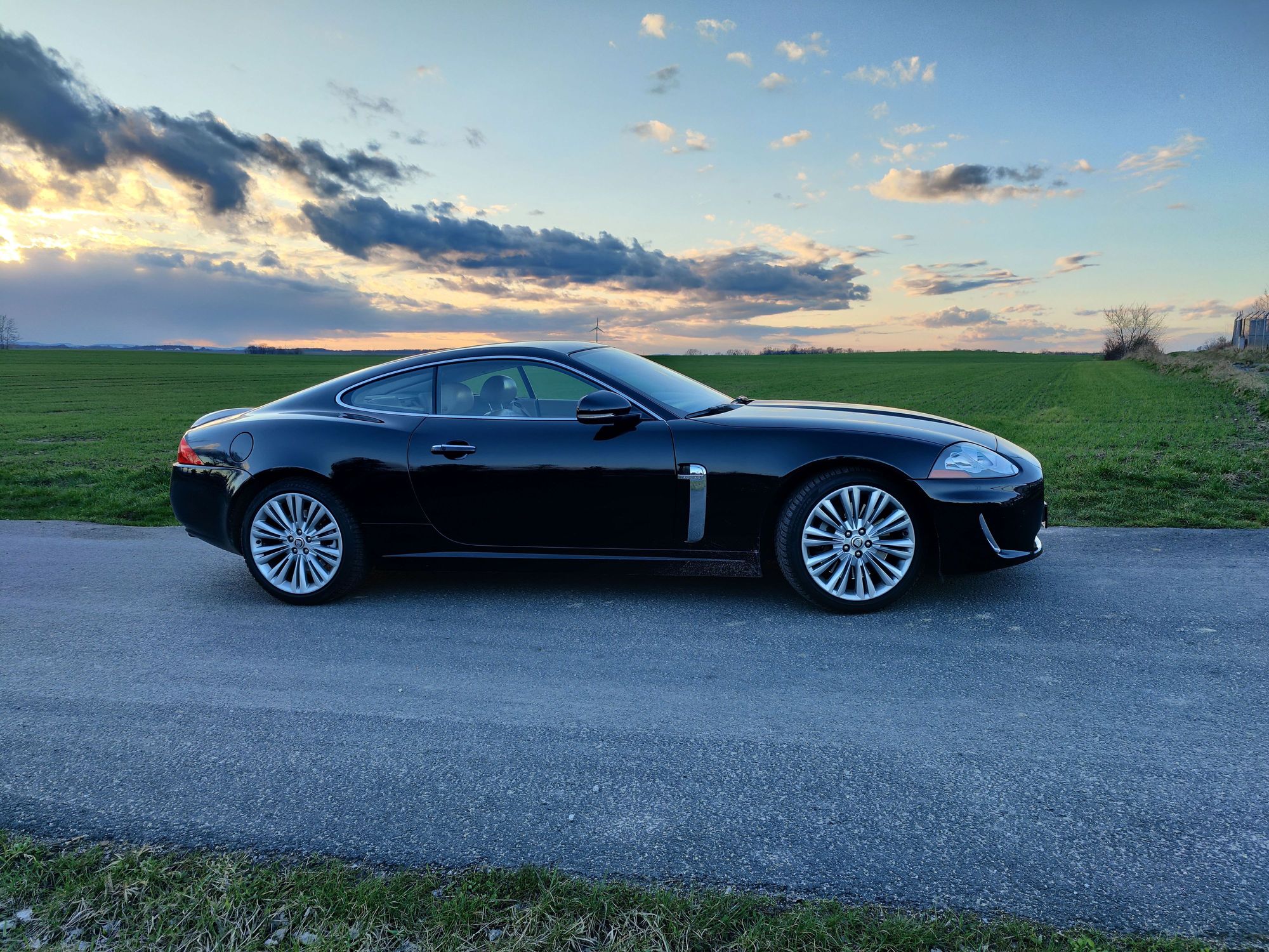

Photo of the patient with mentioned rims
Thanks in advance!

Like this with H&R 15mm spacers ?

Old Jun 22, 2023 | 04:51 AM
Brachacz's Avatar
Joined: Feb 2023
Posts: 131
Likes: 121
From: Poland
Whoa, looks perfect!
Did they fit without any modifications / filing?
You just take the wheel of, screw on the spacer, put the wheel on?
Is it 15mm on both axles?
Do you maybe have a link to specific product?
Old Jun 22, 2023 | 05:25 AM
earny's Avatar
Joined: Nov 2012
Posts: 220
Likes: 140
From: Cologne Germany
15mm on both axles, a mechanic made the mounting during an inspection four years ago - no problems known. Sorry, no link available.

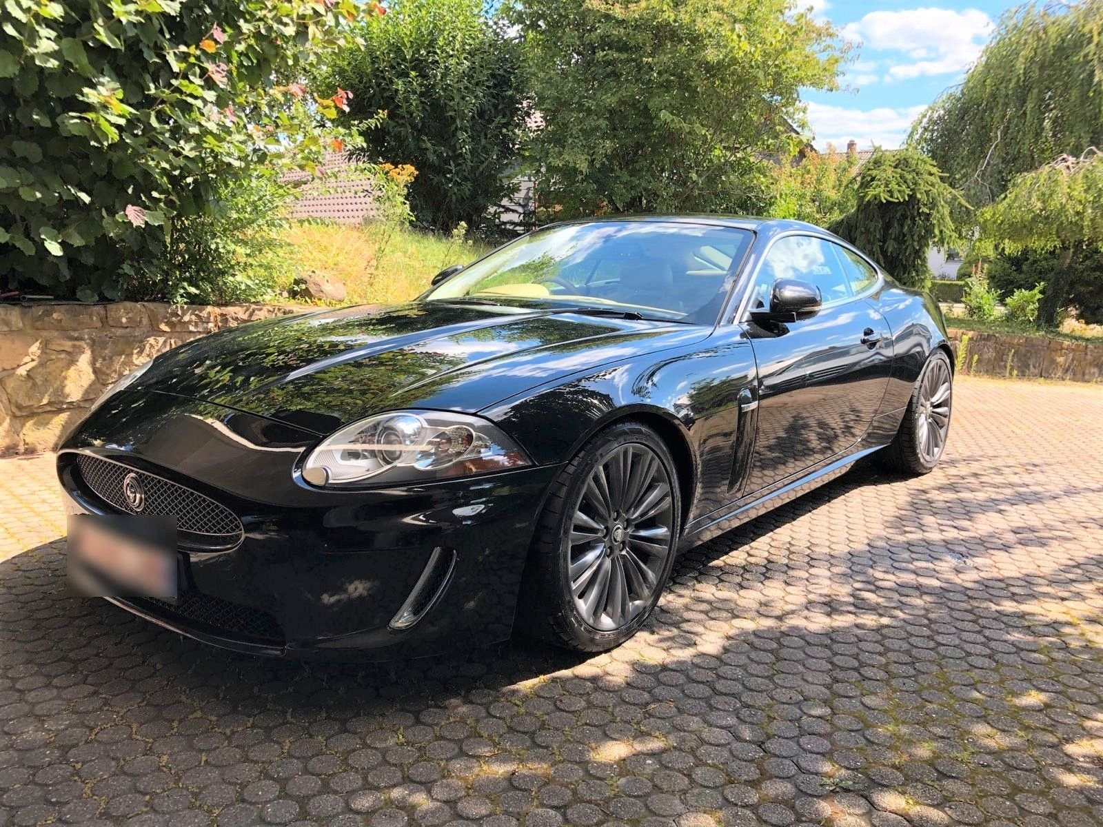

One more question, did you fit the rear bumper protectors? These little plastics that prevent debris from rear wheels from hitting the bumper?
Like on this photo:

No plastic "protectors" - lowered with H&R also, yes. ;-)
I believe the ‘spats’ were factory fitted for cars shipped with 20” wheels. You can buy them separately, I don’t recall the part number. Bought a set for my XK, but haven’t installed them.
