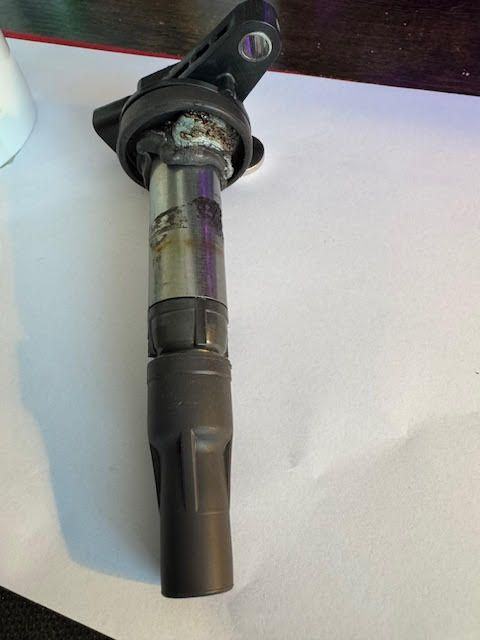

Thanks all - problem sorted. Coil pack on No5 had gone bad and knocked everything out - soon as it was changed she fired up no problems. The rest are the same age as the one that failed so decided to change all of them.

Old Feb 6, 2025 | 03:33 AM
MrWolf's Avatar
Joined: Nov 2022
Posts: 34
Likes: 25
Ah okay - fair enough. Here is the culprit from mine..... melted !
Old Feb 7, 2025 | 08:07 AM
JagV8's Avatar
Posts: 27,546
Likes: 4,924
From: Yorkshire, England
Ouch - that's not good!
Is this the replacment one? never skimp on MAF sensors, Coils, Plugs and O2 Sensors...!
