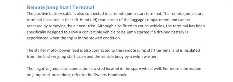

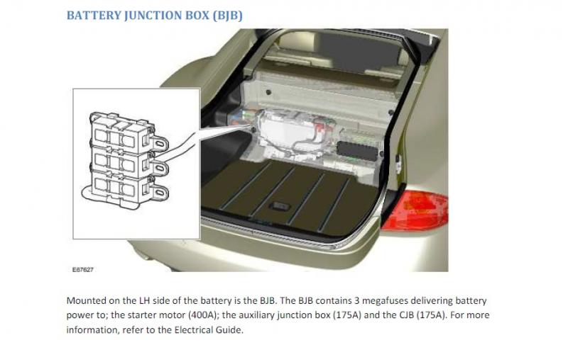

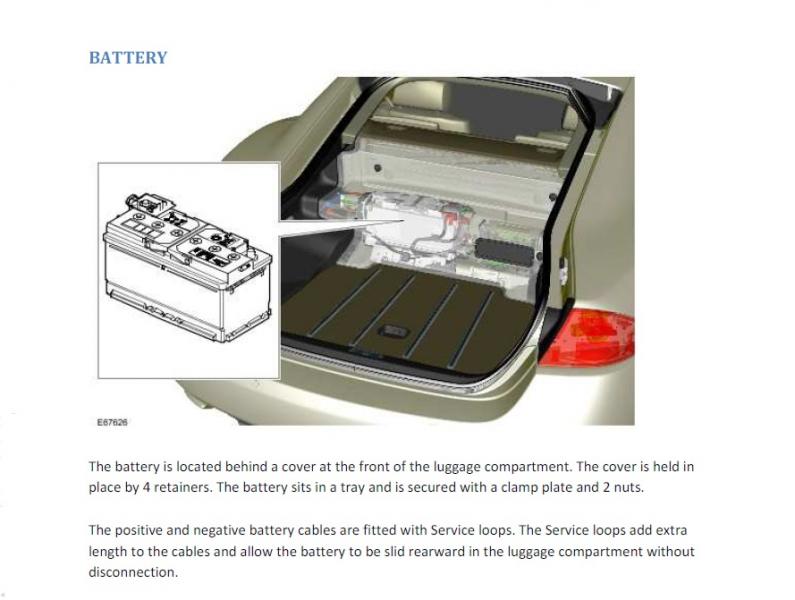

Does this extract from the Workshop Manual help identify things?
Almost makes you think they build the car around the battery.
