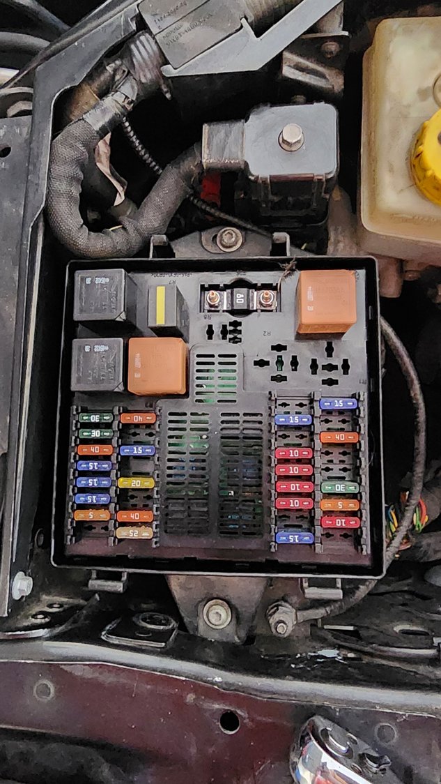

My 07XK is giving me problems. It's more than likely self inflicted but it's still a problem. I was changing out my upper control arm on the drivers side and moved some of the boxes in the attached photo so I could reach the nut. After I got it changed out, my car would start intermittently. I couldn't figure it out and then remembered I moved the fuse box and the little box above it around. I would jiggle those and tighten them and then the XK would start. Well now, nothing. The car lights up and when I crank it I hear a ticking sound but nothing. Anybody have any clues on what I should check?

Start with verifying available voltage. Use a voltmeter across the battery terminals to read the available voltage with the ignition in the OFF position. There should be a minimum of 12.6 volts for all the modules to function properly. If the voltmeter shows less than 12.6 volts, charge the battery for five hours at 2 to 5 amps and retest.
Once you verify the available voltage, check the connections on any of the wire looms you moved.

NBCat, I have 12.6 on the battery. I checked but can't see any loose wires. Can I check the continuity of each fuse to see if something isn't connected properly? Do you know which fuse controls my starter?

The starter is controlled by a relay and the brake pedal switch. Sometimes one must press down very hard on the brake pedal to engage the starter motor.

Stuart, that didn't work. I'm pretty sure I did something with that box. It was starting intermittently and I would wiggle the box and then it completely stopped. I can't figure out how I can test the relay or fuse when I push the start button to see if it's getting power.
