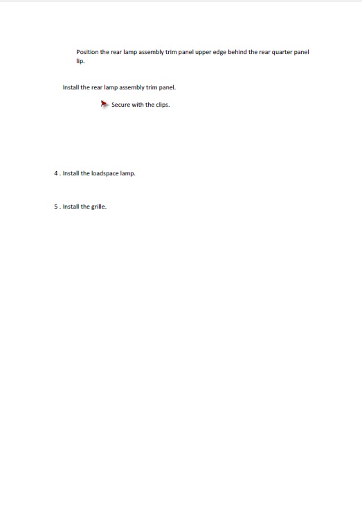

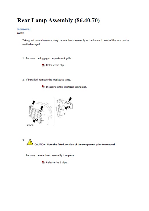

Originally Posted by Andrew 07 XKR
How do you replace the bulb when its out though? I took off the two nuts that are visible but the light housing still would not come off. Advice? Oh oh, is the advice going to be to read the owners manual?
NO - read the Workshop Manual.
2007 XK - reverse light bulb, how to replace-tail-1.jpg 2007 XK - reverse light bulb, how to replace-tail-2.jpg
2007 XK - reverse light bulb, how to replace-tail-3.jpg 2007 XK - reverse light bulb, how to replace-tail-4.jpg
Double cick on the images to enlarge them.

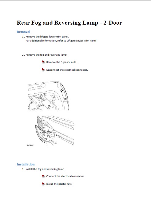

Graham, the original question was regarding the reverse lamps in the hatch / boot / trunk, not the brake / turn housing in the body.
Old May 15, 2018 | 05:18 PM
So it was. Too many threads open and I wasn't concentrating.
Even easier - unbolt 3 nuts, disconnect and throw it away.

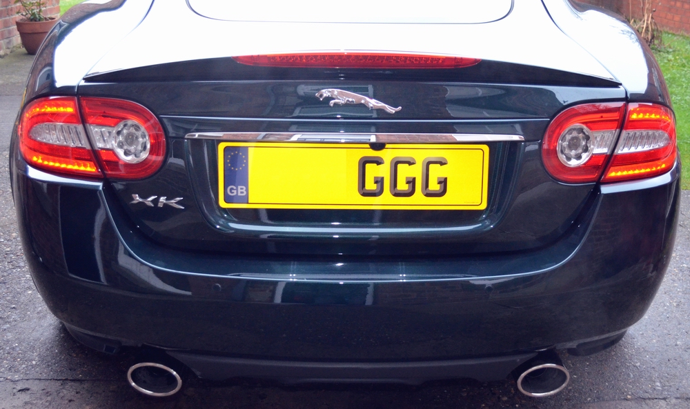

After last winters frozen door window fiasco .....
I hope I never get that.
Our European standard registration plates cover the lock in the luggage compartment lid and they are stuck on!
