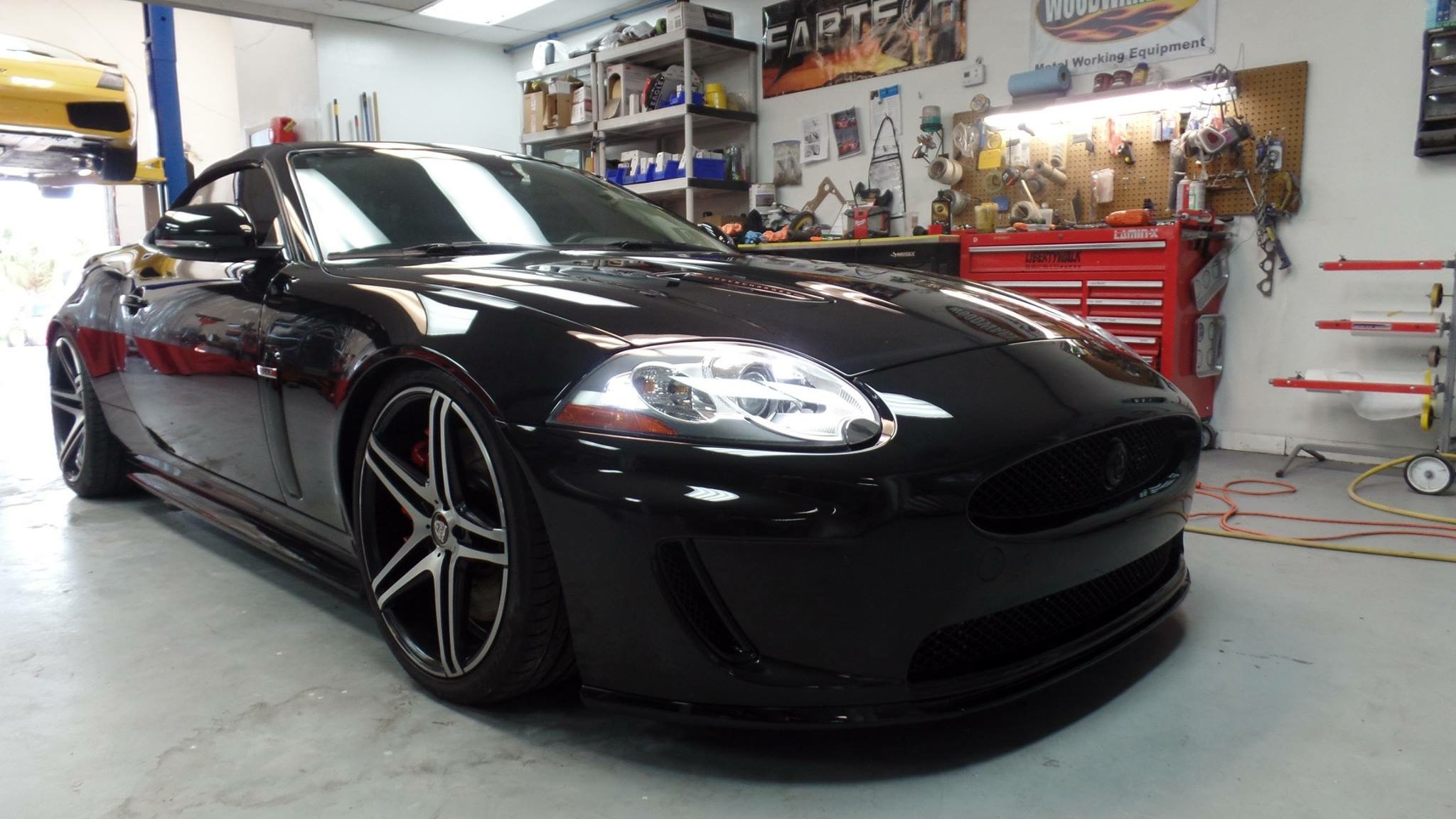

I just installed my kit on MY10 XKR. I purchased from Mina Gallery. The rear diffuser and side skirts are the same for all years. The front splitter is different for your model due to front bumper being different.2007 xkr body kit.-img_8397.jpg

Originally Posted by Guille
I just installed my kit on MY10 XKR. I purchased from Mina Gallery. The rear diffuser and side skirts are the same for all years. The front splitter is different for your model due to front bumper being different.Attachment 124099
Attachment 124100
Guille your car look awesome, very mean appearance, any more allround pictures.

powerhouse, by the looks on your pictures you already have the front and side moldings that come with an RS. You may only need the rear diffuser.

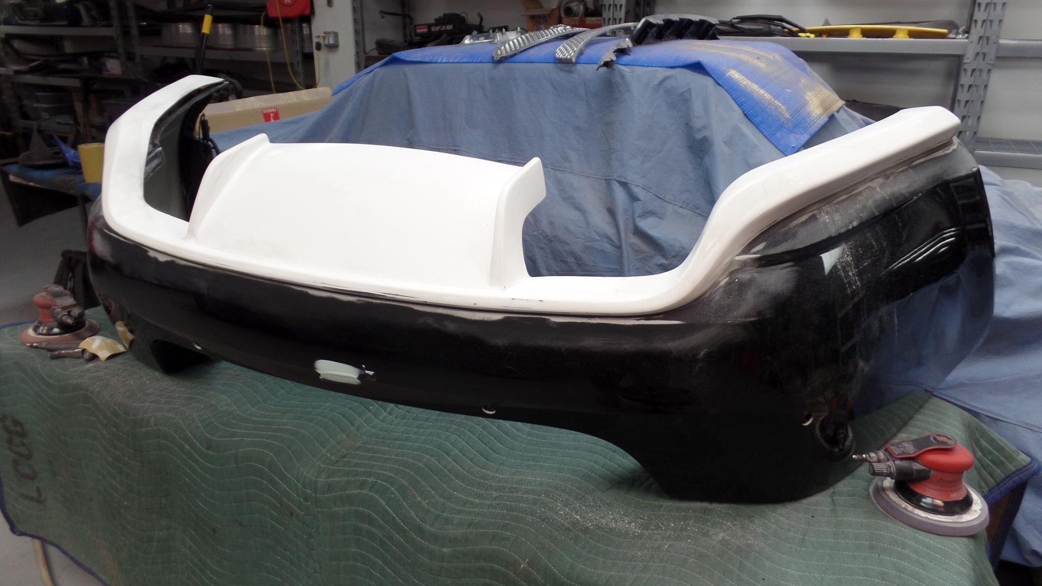

Chris (Mina Gallery) stopped listing the kits cause some need body work and are not always a perfect fit. My rear was actually molded on or if not their would be some gaps. You also have to screw the diffuser to the rear bumper. Its a bit complicated. not your regular bolt on like the front splitter.
