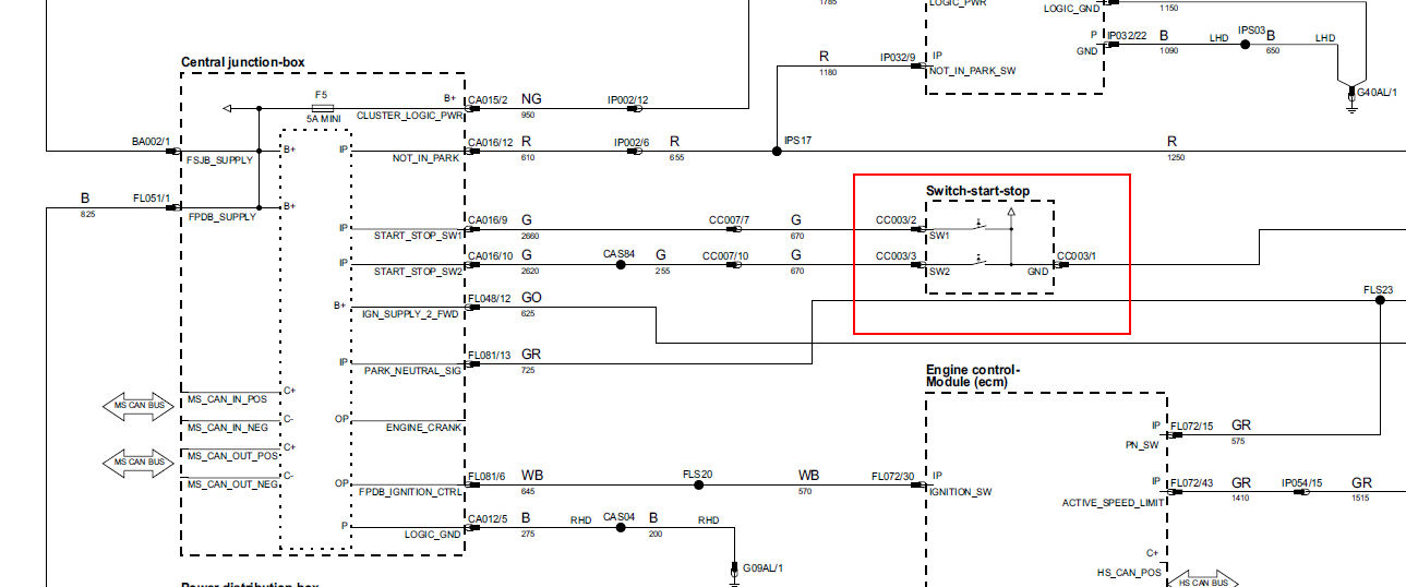

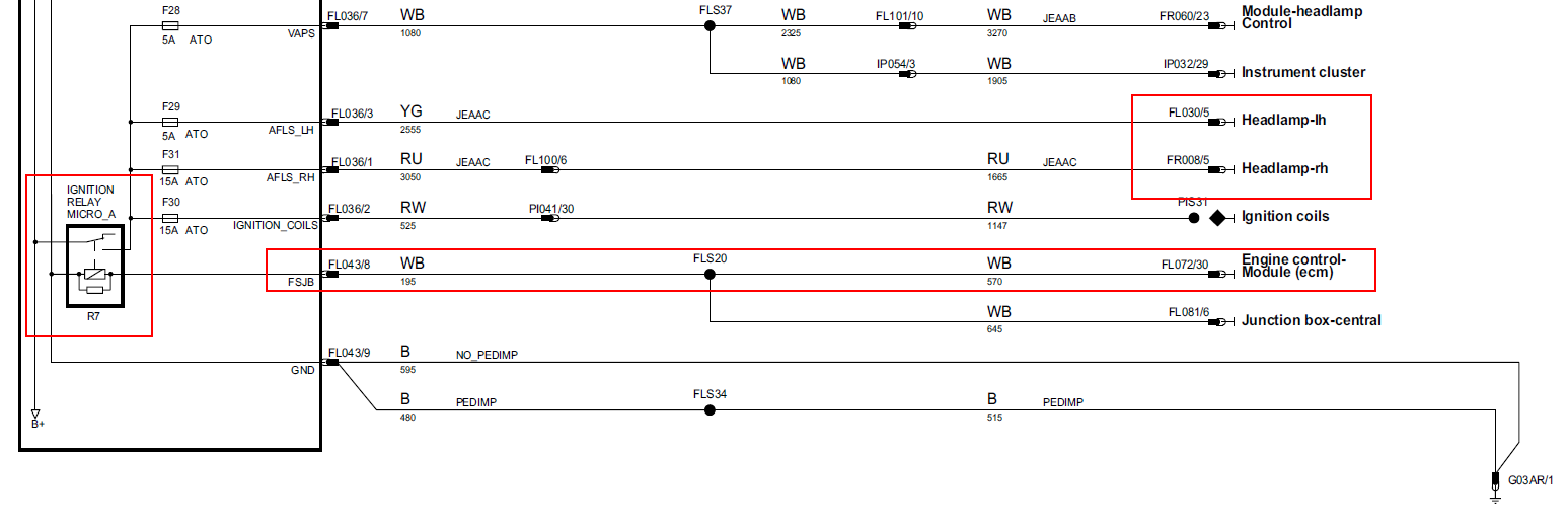

I would check fuses. From the schematic looks like the ignition relay is not operating (no lights) - could be the ECM (powering the ignition relay) acting up. Of course weak battery my be an issue as the Jags can be fussy:
