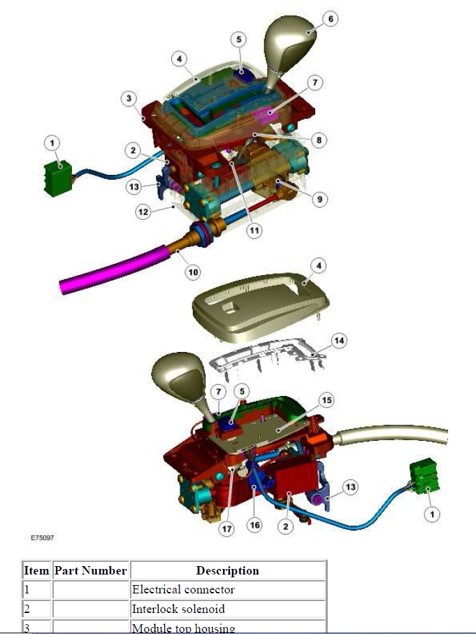

Run jumper wires to the solenoid? There has to be a way to do it, even if it means taking other things apart.
Old Oct 27, 2023 | 11:50 PM
  #42
McJag222's Avatar
Joined: Jul 2016
Posts: 1,451
Likes: 857
From: Vancouver BC
Might be able to manually toggle the solenoid. Shouldn't be too hard to get in there:
Old Oct 28, 2023 | 02:13 AM
  #43
u102768's Avatar
Joined: Jan 2010
Posts: 2,941
Likes: 1,511
From: New Zealand
Yep, jwooky did that:
https://www.jaguarforums.com/forum/x...solved-247702/

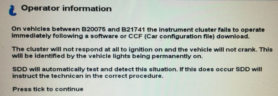

The instrument cluster could be the problem as it links the high and medium speed CAN buses and LIN bus together and there is a bug in some of the 4.2 litre cars that gets flagged during a reflash of the ECM so I wonder if having the battery out for a long time has caused an issue:
I know when I apply a tune to both my 07 and 10 XKRs that while the ECM is being reflashed the headlights come on and the wipers flick across for one cycle so one of the modules may just need the firmware reloading.

Hi was still studying at two oclock this morning, looking at the jag workshop manual and the elitrical diagrams that McJag highlighted. I also read up on the SDD and its process, finding intresting instruction manuals on CCF managment etc. from what i can understand there is a process with the SDD that requires the ignition to be cycled. Post 47 from Bill400 suggested using the SDD and at post 48 McJag asked Bill if this would wake up varuious modules without the ignition being on, Bill hasnt responed as yet so not sure if an SDD would actually be able to do anything.
Reading the screen shot you attached it says the instrument cluster wont respond to the ignition on, which reading between the lines may mean that the ignition would still come on it is just the instruments that would not respond

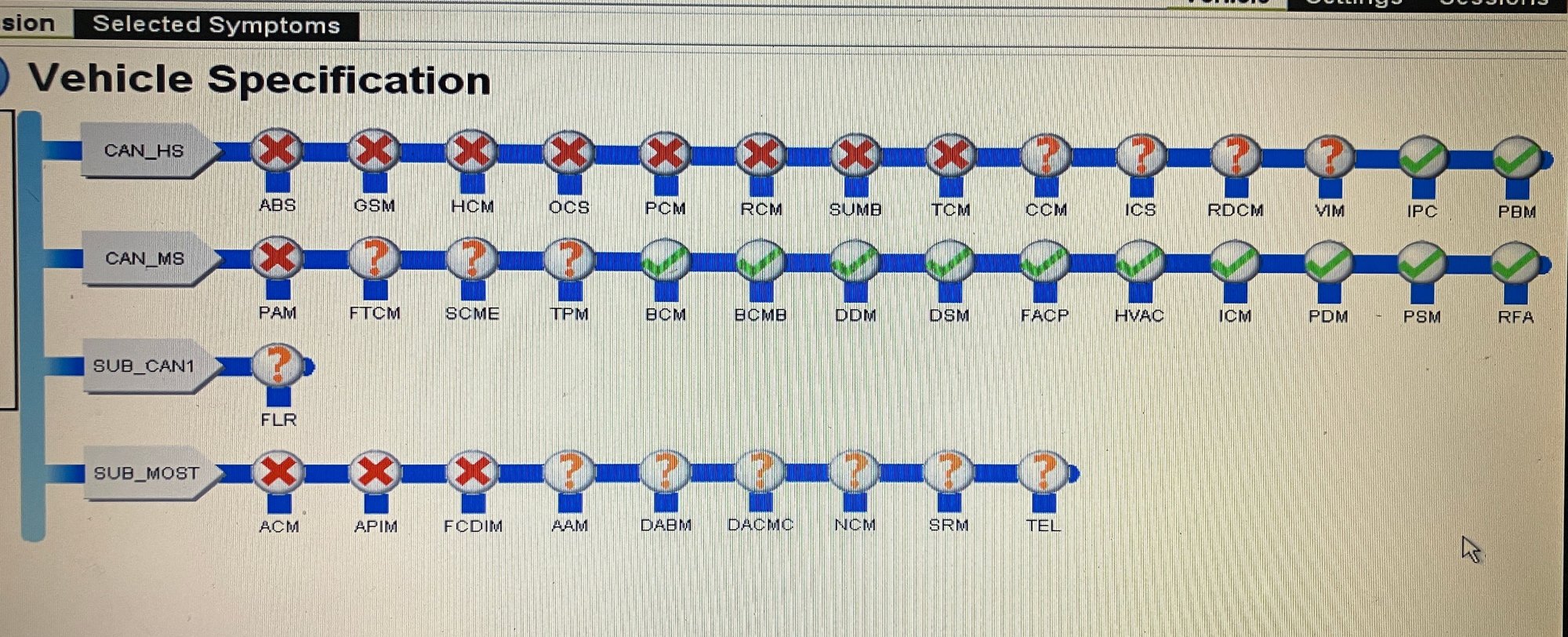

SDD can definitely still talk to some of the modules with the ignition off. I have just plugged my SDD into my '10 XKR which is currently locked in the garage and hasn't been used for a couple of days.
It detects the VIN and this message also appears during the SDD session startup sequence:
These are the modules that it could see with the car locked and asleep. One of the key ones is IPC which is the instrument panel and it would be interesting to compare it to what yours sees when the car is unlocked and in convenience mode:
Out of interest, what is the LED doing, if anything, for the PATS security system at the front middle of the dashboard, by the windscreen. Mine flashes every 3 seconds while the car is locked.

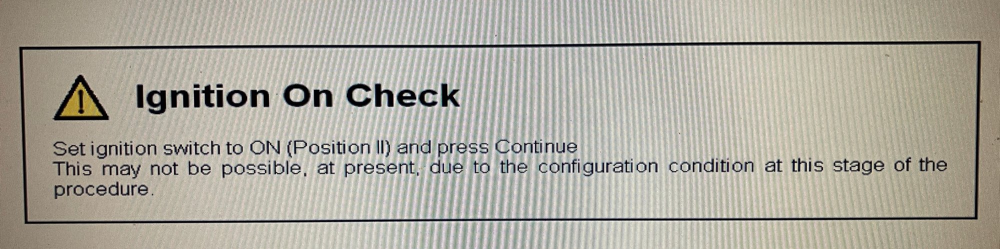

Watching sdd how to videos shows the first step after connecting to be switch the ignition to position 2,
presumably what you are saying that sdd can energise the system only if the system is already functioning correctly, I.e position 2 can be activated?
Old Oct 30, 2023 | 11:07 AM
  #59
Bill400's Avatar
Joined: Aug 2012
Posts: 823
Likes: 437
From: Mechanicsville, Virginia, USA
If position 2 cannot be achieved, SDD will ask if you want it to proceed.
