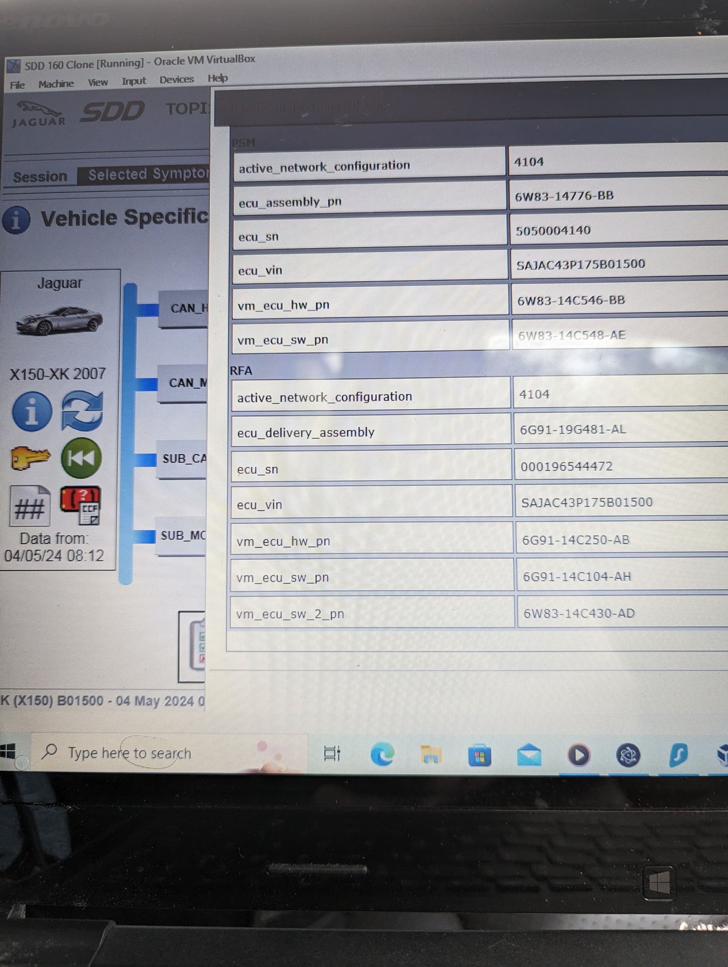

I wish it was that simple. All that happens after unhooking the battery and reconnecting is the wipers start going even though they should be switched off and rear lights coming on.
The battery is good it was changed when I got the car a few months ago and I have even tried a booster pack which made no difference.
The car is behaving exactly as the op described even the screen shots posted are the same. Will try and upload some pics I took in sdd.

Hi thanks for replying glad you got it sorted eventually. I sorted mine by buying second hand bcm's the front one I had cloned but the rear was corrupted as well. So I got a used one of eBay and flashed it myself with sdd and got my car back.
