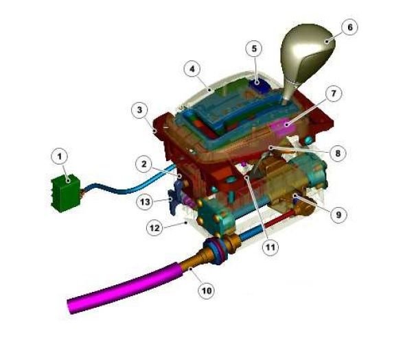

From the Workshop Manual.
Selector lever Interlock Solenoid is item 2:
When energized, the solenoid engages an interlock lever preventing the selector lever from being moved. When the footbrake is applied, a signal from the brake switch de-energises the solenoid allowing the selector lever to be moved from the 'P' or 'N' position. This prevents the selector from being moved to the 'D' or 'R' position unintentionally and the application of the brakes also prevents the vehicle 'creeping' when the gear is engaged.
If electrical power to the selector lever is lost, the selector lever will be locked in the 'N' or 'P' position by the shift interlock solenoid if moved from the 'D' position. The selector lever will remain locked until electrical power to the selector lever is restored. There is
no emergency interlock solenoid release mechanism on the selector lever.
There is no equivalent of the manual release on earlier Jaguar models.
Yes finally figured that out. That’s why I could not find it obviously.
I ended up taking the shifter apart and shifted in manually to get in garage to replace/repair the solenoid.
