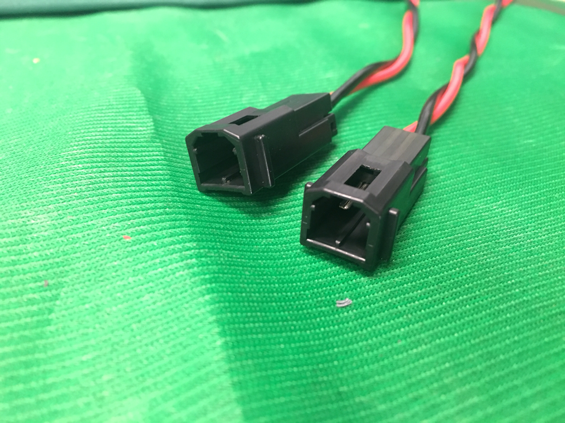

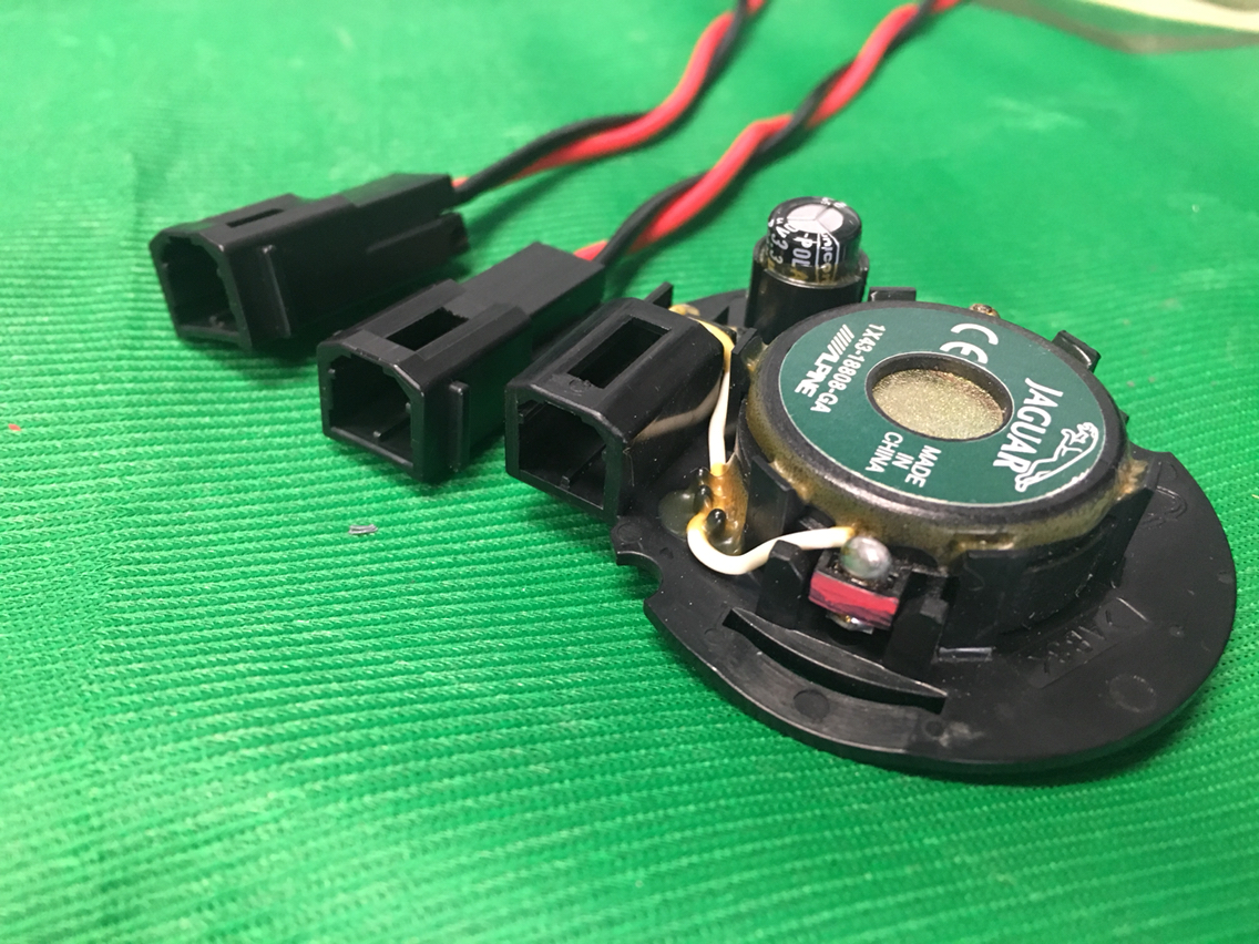

The tweeters in the XK are the same as the ones in the X-Type and X350 XJ.
I've made some adaptor harnesses so you don't need to cut wires if you're fitting aftermarket speakers or tweeters.
That tweeter in the picture is one of the Premium Sound versions, which would also be straight swap for the standard ones.

I wonder though if I bought a new pair of tweeters from Alpine,JBL or Pioneer would give me better sound then a pair of secondhand OEM?
Something should have improved over the years?
