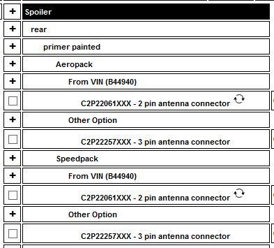

Hi, I'm about to order the larger "Speed Pack/Aero Pack" spoiler for my 2010 XKR that currently has the smaller of the two spoiler options, but the guy at the local Jag dealer parts dept needs to know if my car has a 2 or 3 pin connector to the spoiler. Apparently, Jag changed the antenna on later years, and went from a 2 to a 3 PIN, or a 3 to a 2 PIN. I really don't have the time to take the trim pieces off to look, so does anyone here now the answer? Thanks in advance.

Yours has the same as mine, two-pin on car side and spoiler side. I cut mine up to match, not really a big deal.
Some people take the old stuck-on antenna off both spoilers and swap them.
Crappy picture, camera focused on the grommet instead of connector...

got it, tnx! so now i need to make sure the part number for the spoiler is the 2 pin and not the 3. this should be fun getting the guy at the parts dept to figure out which one it is, as jag has done such a poor and confusing job with all of this.

Since the larger spoiler is almost exclusive to the newer cars 2012+, you may have a hard time finding a large one with a two-pin.

true. the hope is that as the 2011 XKR 175 has that larger speed/aero pack rear spoiler, that i can just order one for that car.

The aerodynamic pack and speed pack were introduced in 2010 so I wouldn't have thought it would be that rare. My '10 XKR has the large spoiler.
These are supposedly the two part numbers anyway:
