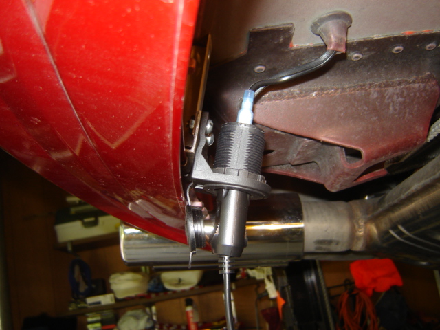

Had to reset the top per the Owners Manual. All in order now. Definitely a rookie move. Curious if you would recommend connecting the charger to the remote terminals or directly to the battery connections?

I found it easy to connect it to the battery + and a ground stud near the battery. Leaving the top up I pulled the top cover assembly and the 4 plastic studs removing the battery cover panel. Once there it is easy to see the battery + positive connection and there is a 10mm stud on the post clamp. Attached the + terminal of the Ctek extension cable. On the right of the battery are a few different 10mm studs some holde the other electronics in the area but just found a stud and check it for ground. Attach the other end of the wire to the stud using a nylok nut. Ran the wire under the short carpet into the spare tire area and taped it down. I then ran the wire out the center water drain rubber plug and attached it to a waterproof marine cigarette acces. socket. I park the car and plug in the Ctek . Easy.
