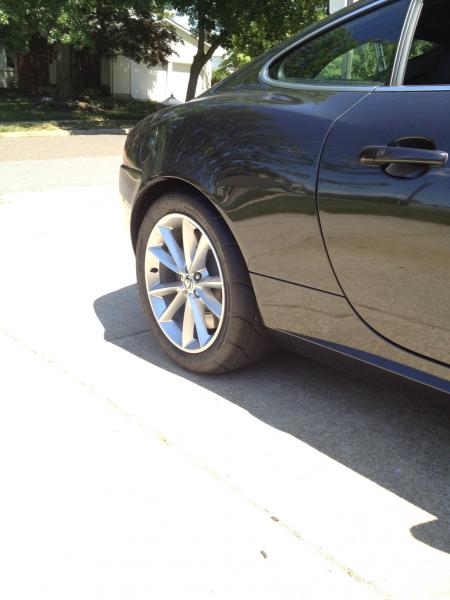

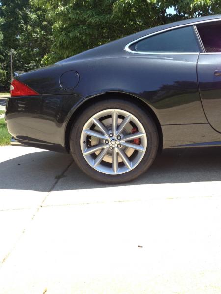

After an unsuccessful attempt at mounting 305/35/20 on OEM wheels (the car freaked out), I managed to get a set of 305/35/19 on 19" oem wheels.
Tire: Mickey Thompson 305/35/19
Wheel: oem 19x9.5 Tamana
As you might imagine the hook great. Actually, they have more bite than the car has torque. Well, at least at 1800rpm. After a burnout, the tire is so sticky, the car will not break the tires lose and the trans will stall around 1800rpm and just sit there. Trust me, an 1800rpm launch is not breath taking. However, the car will run 1.87-1.88 60' all day long...takes the variation out of the mix
Next step is to figure out a way around this issue or spray the car off the line
Here are a few pictures:

Isn't 305 a little too wide for 9.5" wide wheel?

Mike - yup, 305's are a bit wide for a 9.5" wheel...but I was positive they would fit and they at least look close to the fronts.
