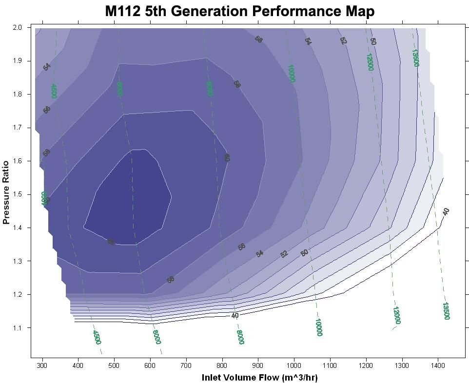

I have attached a dyno sheet from an STR. It is from 2009 so the car was not very old when they dynoed it. I don't think your far off?
Not my car so no details other than what's on the sheet. It has the stock run and then with a pulley. Very light line on the modified curve so hard to see.
The fact is your not going to get much out of the 4.2L SC engine. That old Heaton M112 has it limits and Jaguar designed this engine very well in stock form. The M112 blower was used because of how tough and long lasting it was. For an OEM installation this was WAY more important than getting another 25HP out of the engine.
If you want to go further I would concentrate on improving the charge cooling. Better IC and better pump. Maybe consider Meth injection which helps on multiple fronts? It increases octane of the fuel as well as providing massive cooling from the latent heat of vaporization as the Meth turns from liquid to a gas. Heck maybe even consider a Killer Chiller if you know what those are?
The upper pulley is also a problem as that requires a smaller pulley so your losing belt wrap and will increase the chances of belt slip. Another problem with the 4.2L engine is very limited space for increasing the diameter of the lower pulley. This is really what you want to do as the larger pulley increases belt wrap and reduces belt slippage.
Don't know if your aware of pressure maps? But that tells the tale on increasing boost on the M112. Note this is the 5th generation of the M112 and the best. You did not tell us the year of your car but you probably do have the latest 5th generation blower.
The smaller pulley pushes you out of the high efficiency rings on the chart. So now your in the downward spiral of the M112. The faster you turn it the more heat it makes further reducing power. The factory was very careful to design it so you landed in the center of the efficiency map. Which you will notice is a terrible 62% efficiency. Now you can really see why everyone went to the TVS style blowers. Their efficacy is just way higher than the older designs.

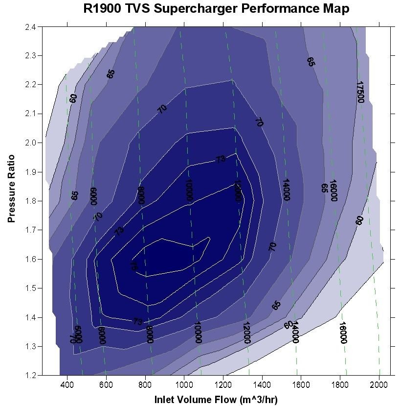

Here is a map of the very nice TVS1900 we have on the later 5.0L SC engines. It's hard to read but the sweet spot is now 75% efficiency! But both blowers hit peak efficiency at around a 1.5-1.6 pressure ratio. More boost is not always the answer to making more power.
