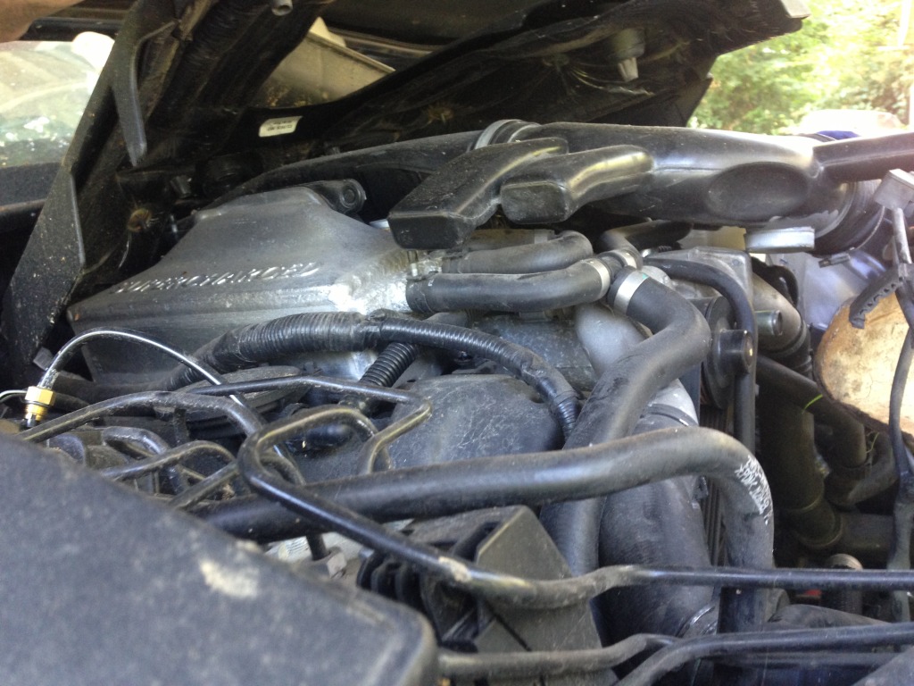

Well I went and looked at the car. The measurements I made make me think it just might fit as is. I would be tempted to try it, but I didn't get a good feeling about the car and the whole deal. (The price suddenly went up, for one thing).
Anyway, I have a a question, because I saw something odd on the air intake. Look for what looks like a homemade fix on the bottom, it looks like someone glued a plastic bottle cap on the bottom.
