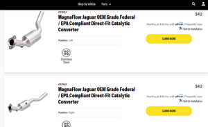

I'm running these Magnaflows no problem.

Those ^ ^ ^ ^ ^ are not bad prices

@Beau M Hi there !
Thanks a lot... Ok cool, price tag is more affordable indeed.
How long have you been using those ?
