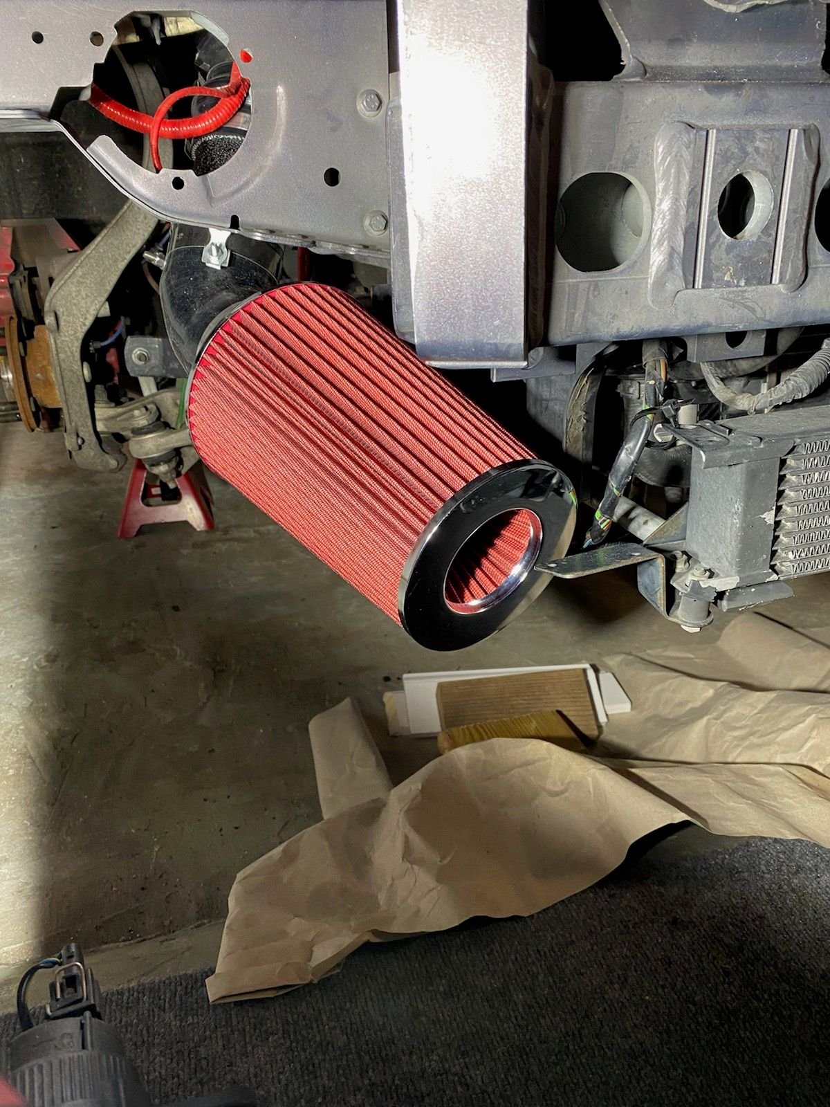

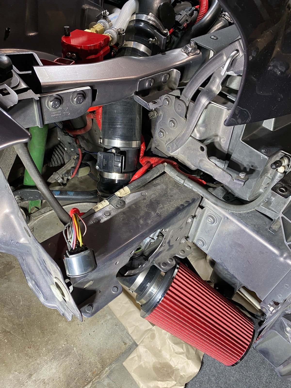

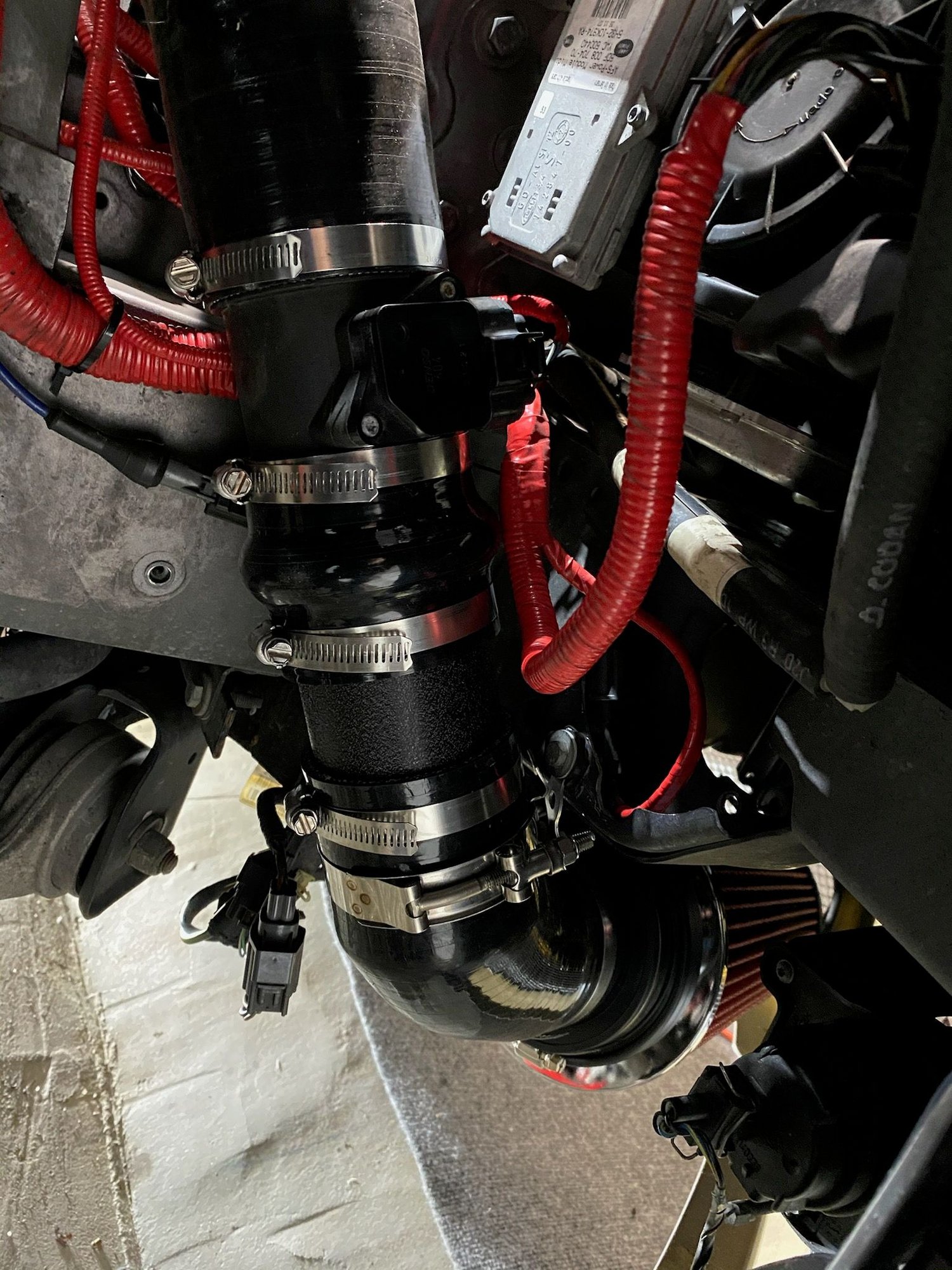

I went with the electrical tape... considering its all over the harnesses in the engine bay and has been holding up well in there.
Everything fit pretty well, however the inner arch liners needed some persuasion to go back in. There is a slight bulge on each side, but didn't look like the tire was rubbing on full lock to lock.
Here are some final assembly pics.
The hangers ended up really simple and came out nice.
Some adjustments had to be made to turn the MAF out of the way. Right now they can be removed/cleaned just by removing the headlight units.
The way they are pointing, I'm actually getting some ram air from the lower grill going into the front of the cone also.
I'm still not sure how to secure the front, so I zip tied it for now. Everything is nice and tight but still loose enough to wiggle. The only 'permanent' modification was cutting the tab in the front bumper seen here.

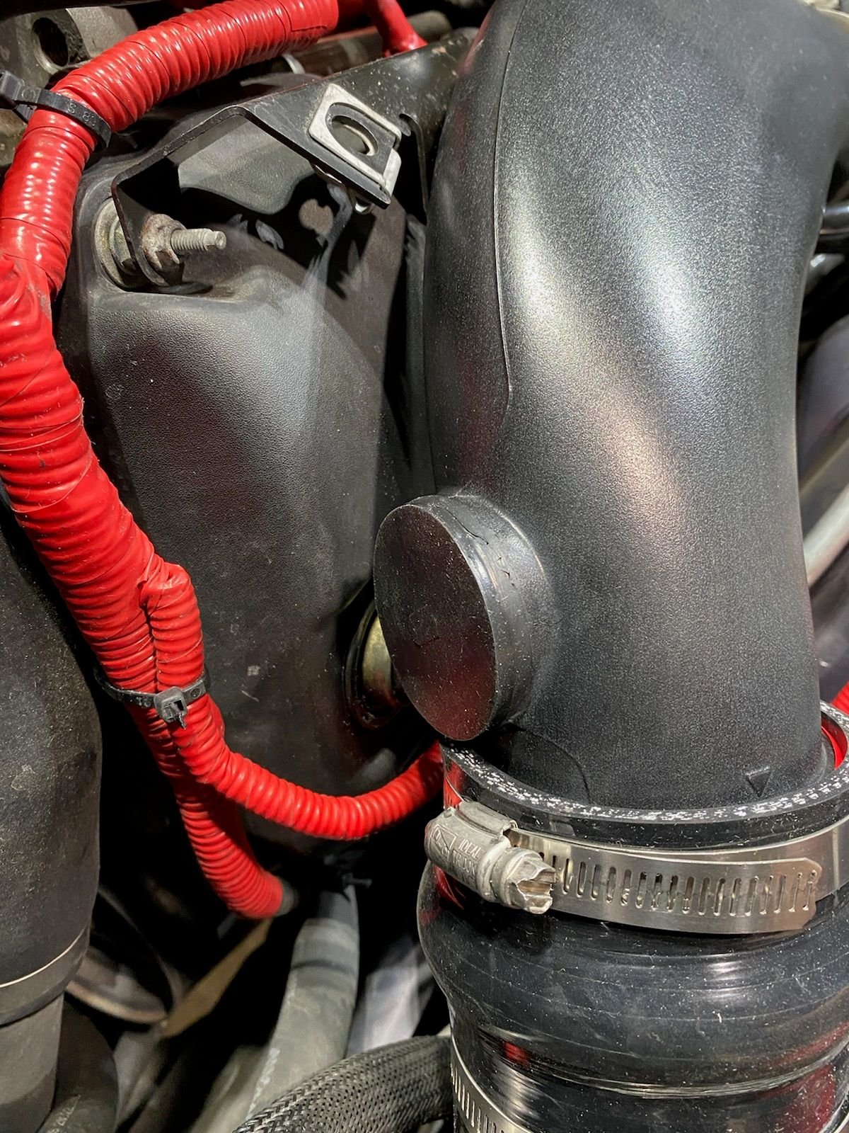

Resonator plugged and RTV'd.

You probably already realize this but you will now have to be careful of exposure to water with the intakes that low. I've not driven through water with them BUT when the filters were exposed to water, their flow was measurably reduced.

Yes I thought about that when I was reading your thread. I will obviously avoid puddles as much as possible. As for rain, the plan was to go to the car wash and see how wet they would actually get. I'll have to test it out another time and just avoid rain for now. Aside from a heavy storm, I don't think rain should be that much of an issue.

There is a cross air straightener screen before the maf unit, did you guys leave it in the aftermarket setup ? Jahummer?

Nice clean resonator plug!, what did you use?
Yes it was retained along with the stock MAF assembly/holder.

I did get a P0101 code on my 2nd test drive, maybe its the fact that I did not use the OEM strainers? Just got back from a trip so need a few more days to figure it out.
The plugs are the white rubber ones pictured above. I used black RTV to seal them and put a thin layer on the top to get rid of all the white.
