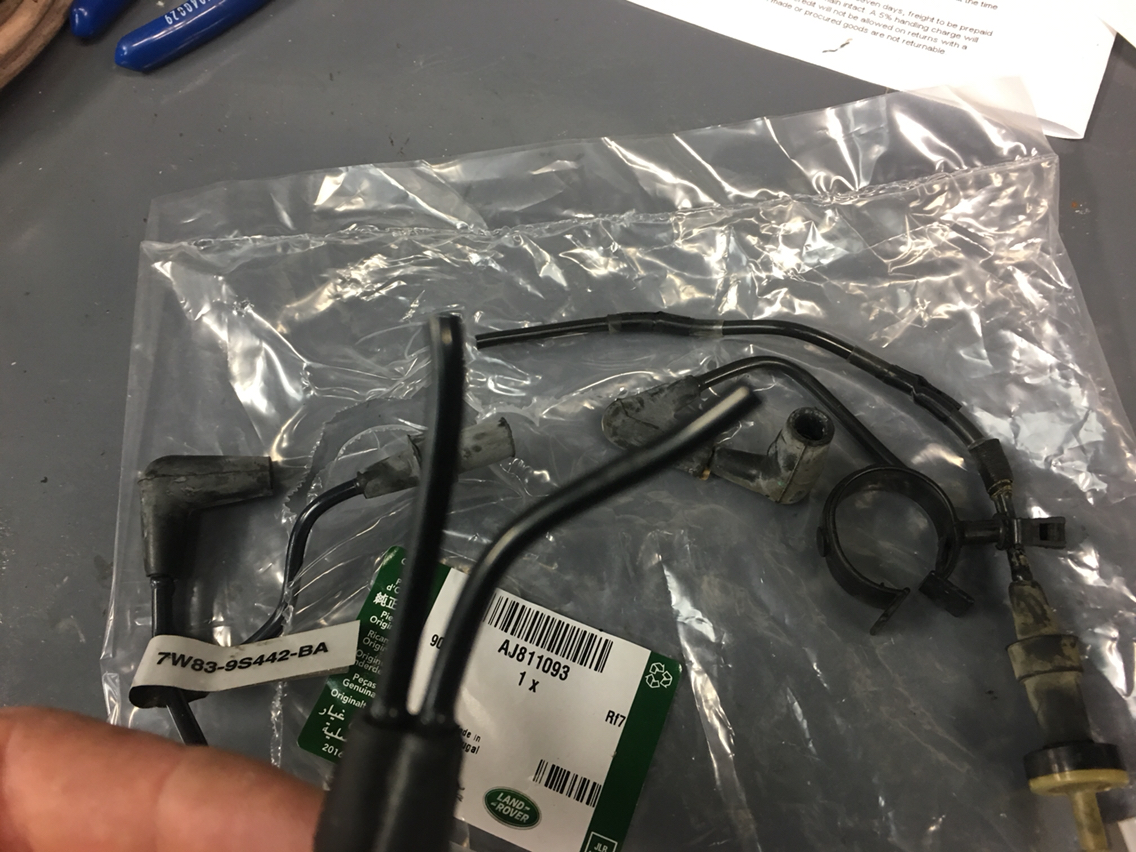

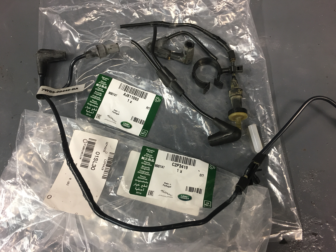

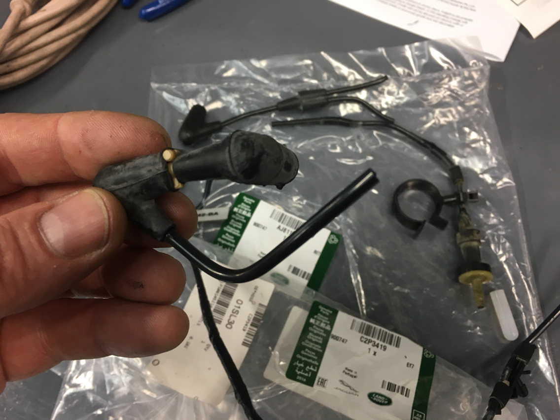

As these cars are now coming up on 10 years old and some are going to have done some miles, you might want to take preventative action on these god awful plastic boost/vacuum hoses.
As they've aged they've become extremely brittle, and snap clean in half if you so much as touch them.
4.2L plastic boost/vacuum hoses - WARNING-photo417.jpg
4.2L plastic boost/vacuum hoses - WARNING-photo549.jpg
4.2L plastic boost/vacuum hoses - WARNING-photo856.jpg
Part numbers can be seen on the bags.
These hoses go from the outlet duct of the supercharger, to the fuel pressure sensor, and on to the vacuum pump in behind the headlight.
Also the connection at the outlet duct of the supercharger gets very hot, and the flared end of the plastic tube that goes into the rubber elbow also loses its grip. Mine blew out and left me with a considerable vacuum leak at idle, such turned into a boost leak when the bypass valve on the blower closed.
The brittle tubing broke in several places when trying to fix this leak.
They are pretty cheap so it's worth taking care of them if you're in there for other reasons.
Put some zip ties on the rubber joints while you're at it.
