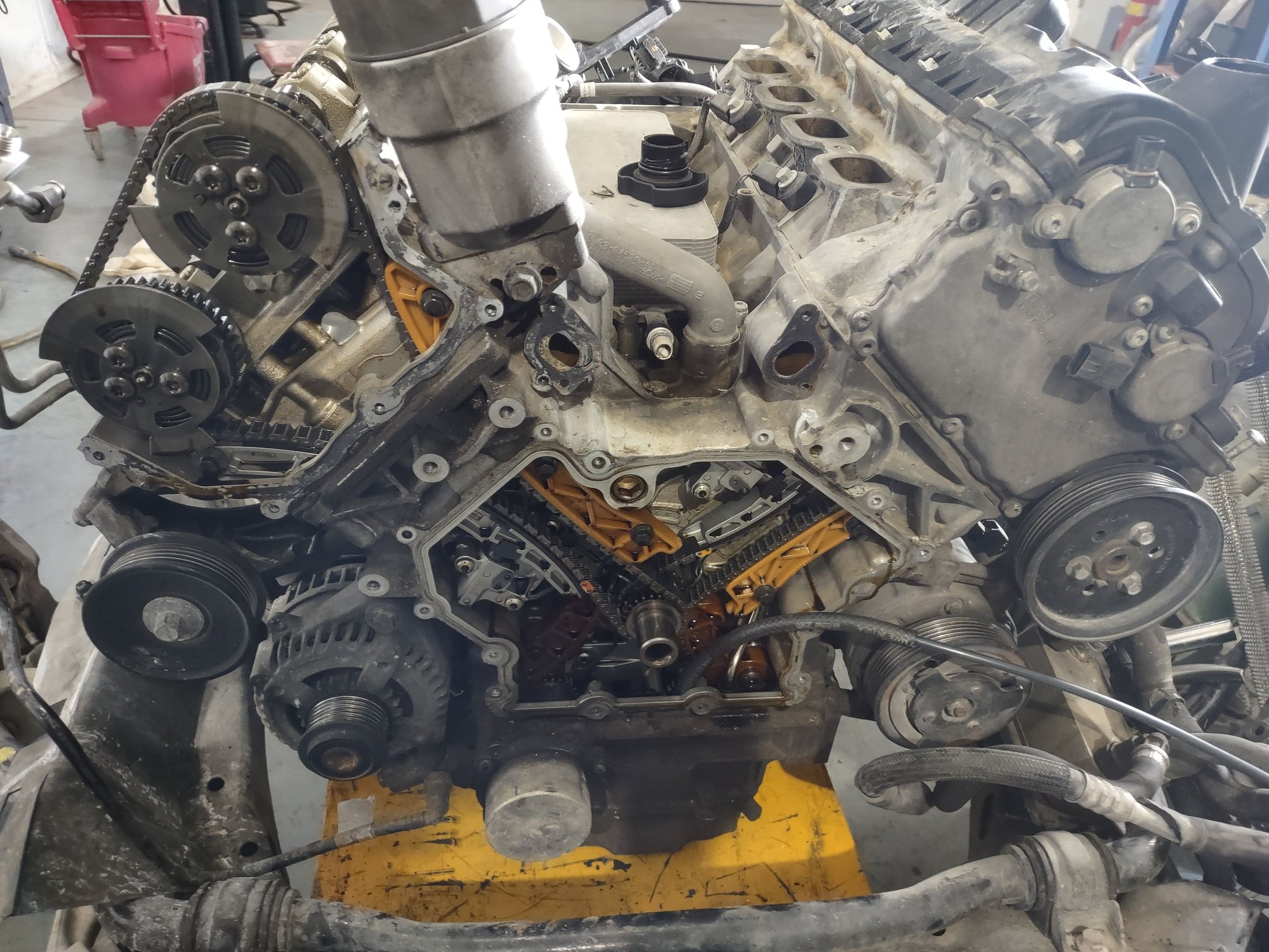

My 2015 XJ been at the Land Rover Jaguar Dallas dealership for over 2 weeks now. I took it there for diagnostic and was told the timing chain is loose and I should replace the entire engine.... is there and reputable shops in DFW area that can repair my car.
how many miles on it? whats the maintenance history?
I would verify this by carefully inspecting the chain with the engine running through the oil filler cap, (carefully)
also with the engine off using a screw driver to poke at the chain and look for play.
Apart from any noise from the timing chain, was the engine running reasonably OK? If it was then it is highly unlikely that the pistons/valves are damaged and all the engine needs is a new chain and tensioners which is not a particularly difficult job.
If the engine was running badly and there had been any banging or knocking noises, then get the cylinders compression tested and/or inspected with a borescope. Once again, a relatively simple job and essential before taking any decision about a new engine being required.
