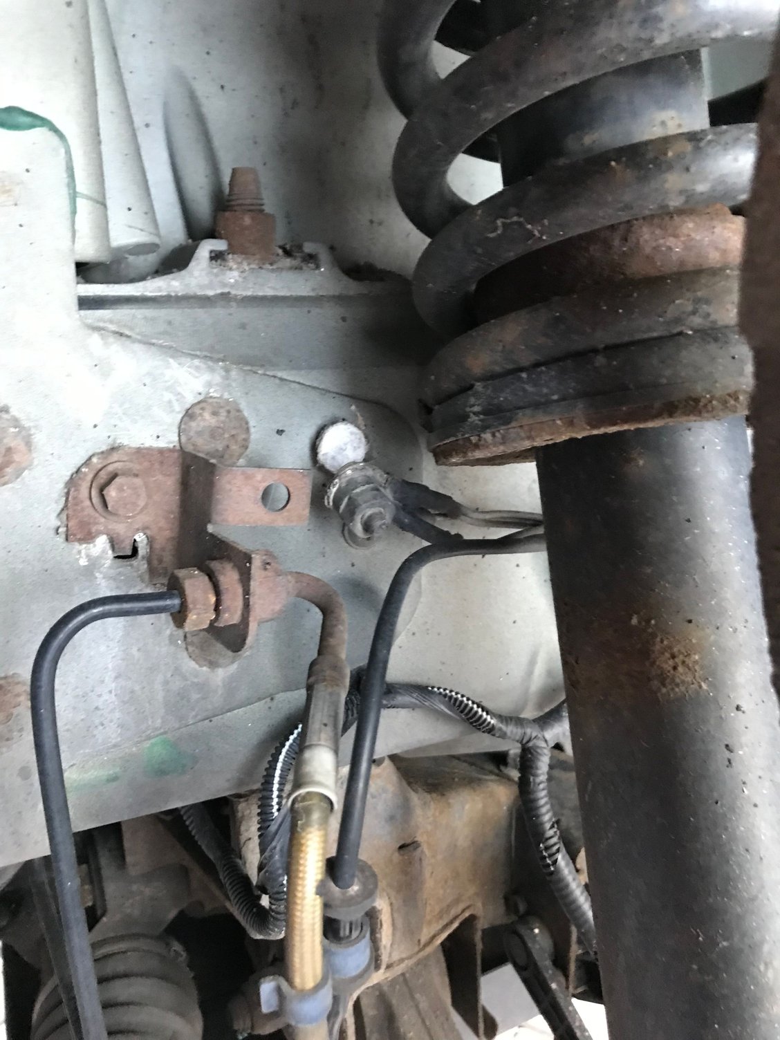

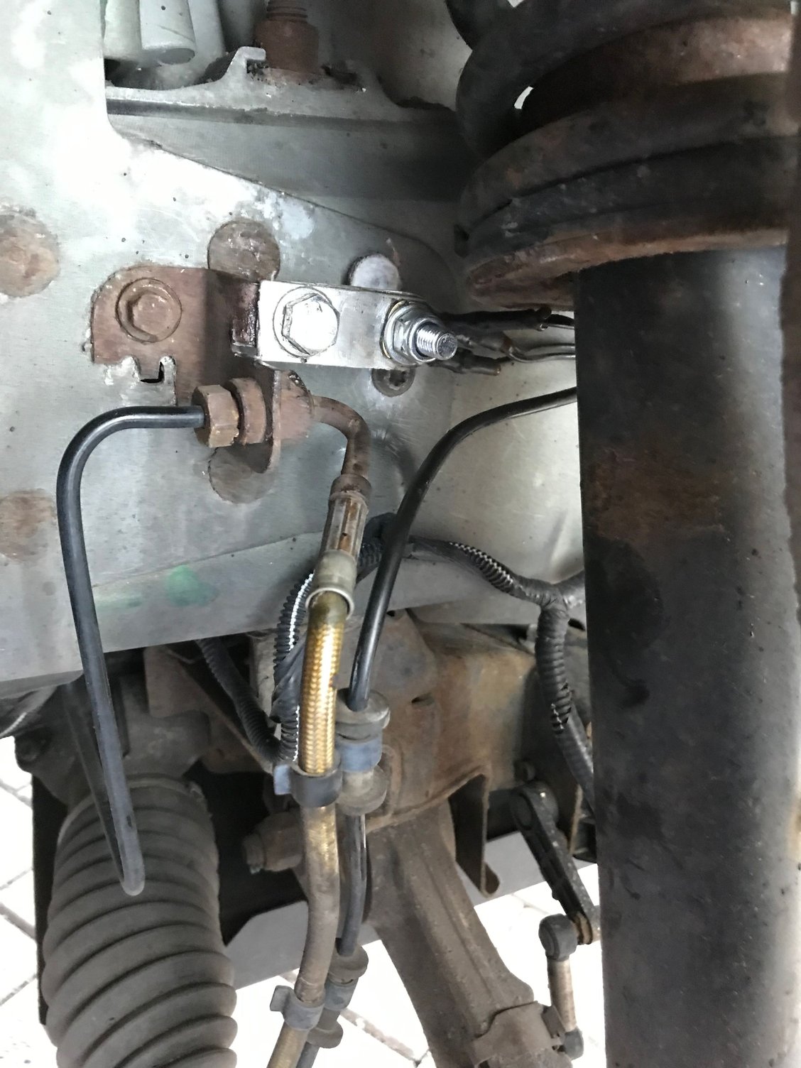

Default Earth lug repair
It happened to me.
The first symptom was the active headlight fault warning, then headlights completely failed about 1/2 mile from home.
I found that the earth lug had completely sheared off (see below)
Fortunately there is a convenient hole in the bracket holding the brake pipe. I extended the earth wires and bolted them to the bracket.
That was a year ago, no further problems since 👍
Earth lug in R/H front wheel arch completely sheared off
Used a short piece of aluminium bar to extend the cable and bolted it to the brake pipe bracket - there is a very convenient spare hole.

use another bolt close to the broken one - there are some which can be used
no hole drilling necessary
