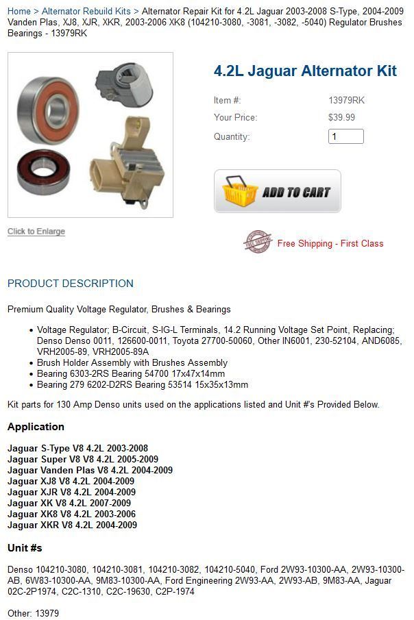

So, my experience with alternators is that they rarely fail. And if they do, it's because the brushes wear out or the regulators parts fail. Far less often, the bearings need to be replaced.
My 4.2 NA uses a Denso alternator, with a Jag price around $1K. You can get replacements from Denso for around $400 new, but more likely $250 or so with a unit rebuilt by Denso. There are Bosch replacements, but that's not the point.
Once you find out the model used, below is is a great source for rebuild parts. I've used these guys before. URL below takes you to parts kits, for around $40. Individual parts simlar.
https://www.maniacelectricmotors.com...-bearings.html
It also has all the cross reference numbers for major sources of the unit. There's a similar page for the other Jag alternators.
Alternators are really easy to fix or even rebuild if you want to. You can put in new brushes and regulator in 45 minutes, Sometimes you can do it on the car if you can reach the back of the unit. Otherwise, its a removal and bench job.
Denso alternators are great units and rarely fail. But if they do, as you pass 150K, here's a source.
Hope this helps someone.
