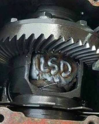

S-Type R is 2.87:1
F-Type V6S, and XK is 3.31:1
You can't put a 3.31:1 in an S-Type R the difference in ratio is too great, will throw up codes and limp mode.
There's no Ford diff with LSD that's a straight swap.
Your choices for the STR are Quaife or mini-spool, or CIG-Locker

But there is no Ford LSD that fits inside the 8" diff housing. We tried them all.
