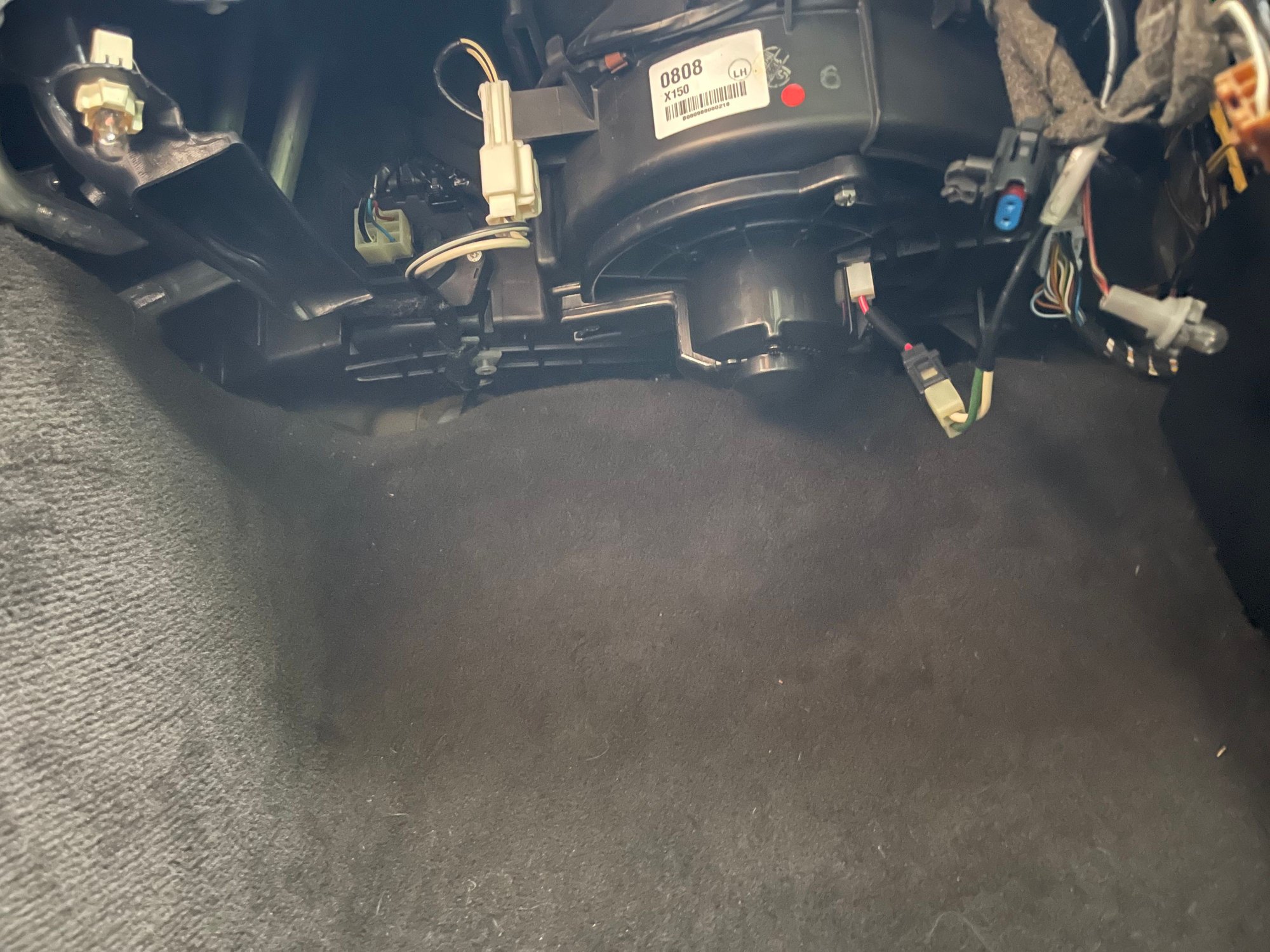

Hello friends, I am in need of some help pretty badly.
A little over a week ago, my blower motor (I believe) gave out, I was actually relieved that the irritating whining sound I heard very often was the blower motor because as soon as it died the whining stopped.
I could still feel cool air coming out of the vents barely, but no blowing despite fan settings etc.
I ordered and received the correct blower motor and resistor, spent a little extra than the DIY motor mentioned in the forums so I could have plug and play fan and motor and do it right, didn't want to mess around with this florida heat starting to pelt.
Today I installed both, can't imagine there was many ways it could be done wrong since it is just screw in and plug in, however I did mess it up the very first start because my blower motor cable was not fully plugged in. I fixed it, started it again and still nothing, I hear some sounds coming from the area, basically same sounds as before I replaced it, but nothing.
I re checked some fuses I already checked before, mainly the AC one in the footwell that is a serious pain to get to, and the back seat one. I replaced the front footwell AC fuse and accidentally somehow bent the plastic part on the brown 5 one next to it, it went back to normal but I replaced it either way. the back 40a ac blower fuses tested fine and I rotated them just to see, when I started the car again, my screen / entire ac system buttons did not turn on. No lights, only button that lit up in the infotainment was airbag light. The last time this happened months ago, I believe it was low voltage that time and the leaper + lit buttons showed up, now it is nothing, I have a picture of all the fuses before I changed them, and they are where they are supposed to be. I know I must have done something wrong but I don't know what. My battery voltage was fine this time, and I got it OBD tested and zero codes came up like normal.
feel like I'm digging myself deeper into a pit and wanted to ask for help, pretty desperate.
Thank you
Attached video of infotainment and sound, and photo of installed motor and resistor.

Considering the resistor’s buried in the middle of the dash are you certain that’s what you replaced? The blower typically fails due to water, did you check the old fan to see if it was really bad? And are you certain the new blower works?
I believe so unless this is the wrong resistor, it was to the left of the blower but a little deeper in. what I believe was the blower, had started to make shrill loud whining, and the noises got worse and worse until it stopped blowing a little over a week ago, (it's still been driven in that time, everything else was fine including nav screen and ac control lights until today, never once had the noises after it stopped blowing, so I know its at least not something in the engine bay)
a bunch of small black particles came out of it, when it was removed, and the bolt looked corroded so I assume it had water damage, when spun certain ways by hand I could hear some of the noise.
This is what I replaced:

No, that’s right, assuming the parts are correct (compared old part numbers to new). And you’ve doubled checked all connections and harnesses and all fuses. Assume the fan speed dial displays the fan speed as you increase/decrease it?
