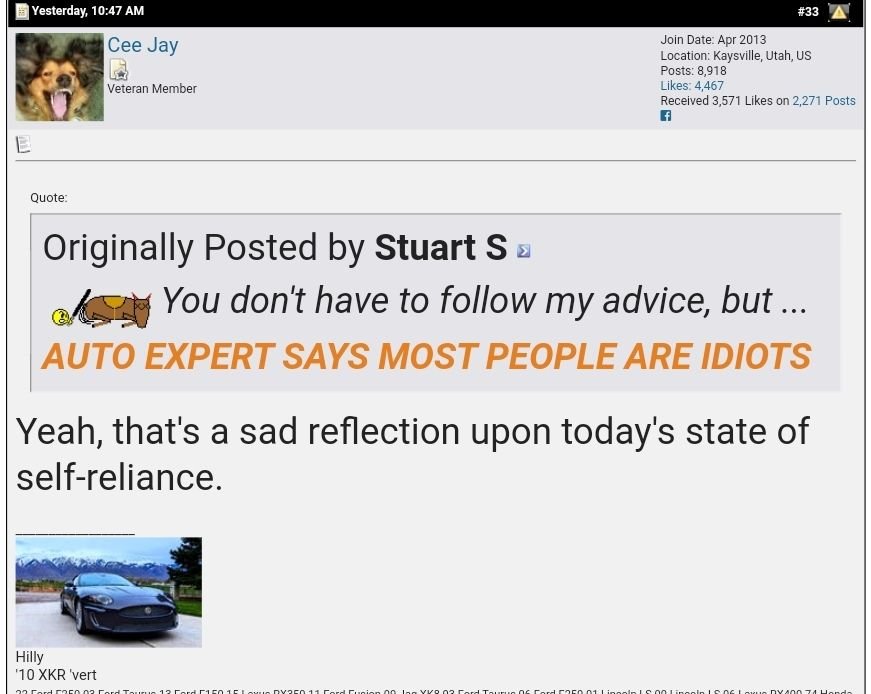

"AUTO EXPERT SAYS MOST PEOPLE ARE IDIOTS"
Yeah, that's a sad reflection upon today's state of self-reliance.
Last edited by Cee Jay; Jun 2, 2022 at 09:37 AM. Reason: My paraphrase was misinterpreted
