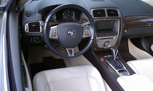

Jaguar steering wheel WITHOUT Active Cruise Control. The clear bra would have no effect on the front park assist. It uses a radar signal to alert the driver.

And here's the wheel WITH Adaptive Cruise Control:
Attached Thumbnails Adaptive cruise control and forward alert-6164164860_9b570012da_n.jpg   Adaptive cruise control and forward alert-6164164860_9b570012da.jpg

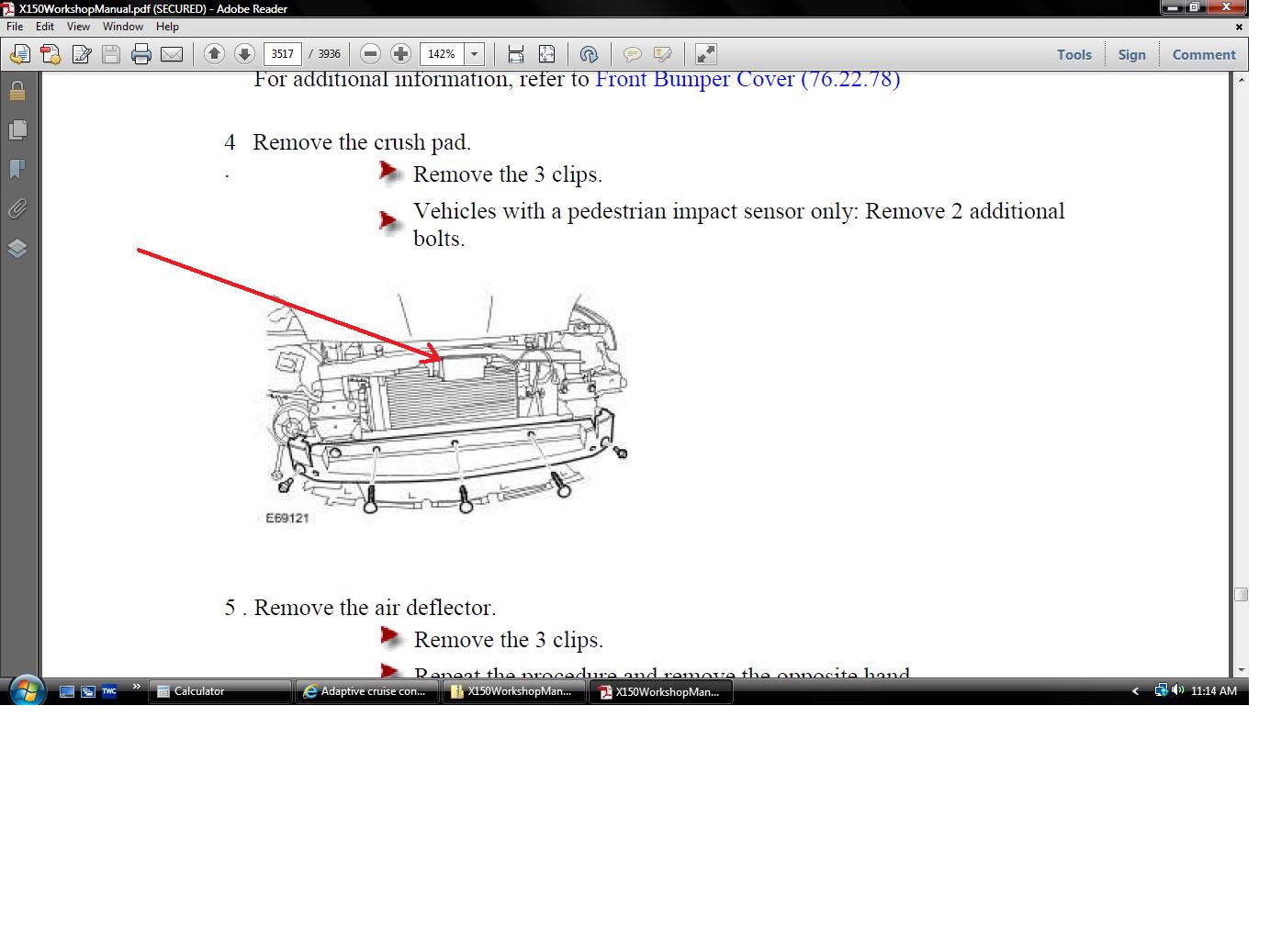

On my 2007 XK The radar unit for the adaptive cruise control is located as shown in the two attachments. I'm pretty sure of that.
Attached Thumbnails Adaptive cruise control and forward alert-cruise.jpg   Adaptive cruise control and forward alert-cruise-two.jpg

Yep it turns out I (and the Jag dealer) were wrong. You're right.
The nose is currently off my car (for touch-up painting to get rid of rock chips), and I saw that what I had thought was the radar box is just a big chunk of impact-absorbing foam. The radar box is actually mounted in front of the top of the radiator, so the beam must pass through the nose just above the upper grille.
