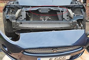

Old Dec 18, 2017 | 05:09 AM
Likes: 17,013
Originally Posted by Cambo
..... When I had the nosecone off my 2009 XKR I think I found the unused wiring harness for the sensor, so it could be that the car is pre-wired. .....
My 2007 has ACC. Here's the sensor and associated harness:
That's a seriously expensive option for a toy I've only used once.

Yeah that looks like the harness in mine Graham, just hanging there not plugged in to anything.
