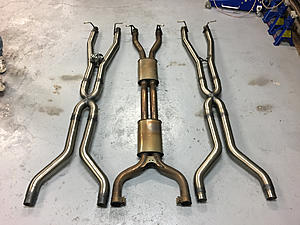

These are the ones I get made locally.
They are done in 2.5" and the ends are swaged to match the 55mm factory pipes.
For whatever reason 2.25" tube is 50% more expensive than 2.5" around here, and in much shorter supply.
