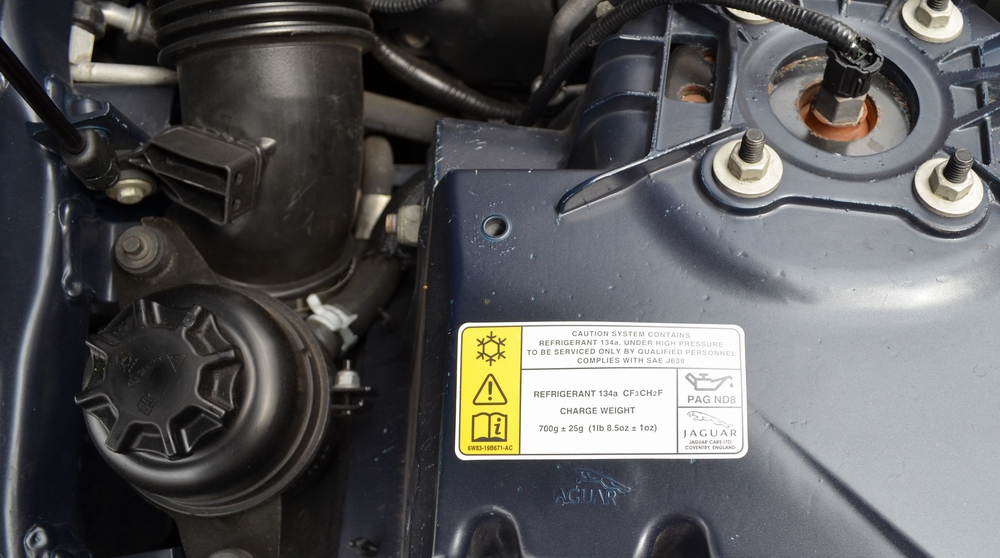

We don't have much need to investigate the cooling abilities of the AirCon in the UK. I'd noticed the XK was adequate but not as good as my previous two XK8's or X308. Recharging with a DIY kit I'd used on other vehicles showed it was up to capacity.
However, on a recent trip to southern Spain where the temperatures hit 98 deg F, the AirCon was only pushing out barely cooled air despite showing 58 deg F on the display screen.
Back at home in the UK, I took it in for a check yesterday. The AirCon charge is 700g but mine only contained 17g. Not surprising it was performing badly!
I was concerned with such a low charge that the system could have a leak but the procedure checks this out. The professional recharge equipment operates as follows:
1. checks existing charge weight
2. completely empties the system
3. applies a vacuum to test the system for leaks (10 minutes)
4. refills with the correct weight of R134a and volume of PAG oil
The AirCon feels considerably colder now (although still displaying the same 58 deg F on maximum LOW). Unfortunately I probably won't have the opportunity to check it in anywhere 90 deg F external temperatures for a while.
Two lessons learned here:
1. DIY AirCon recharge kits aren't reliable
2. the displayed temperature is misleading
