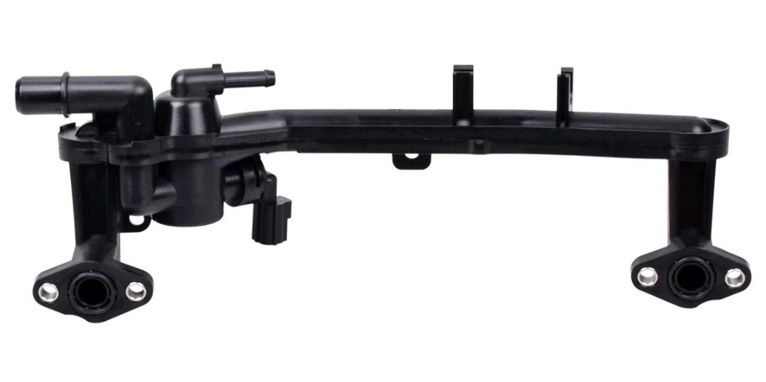

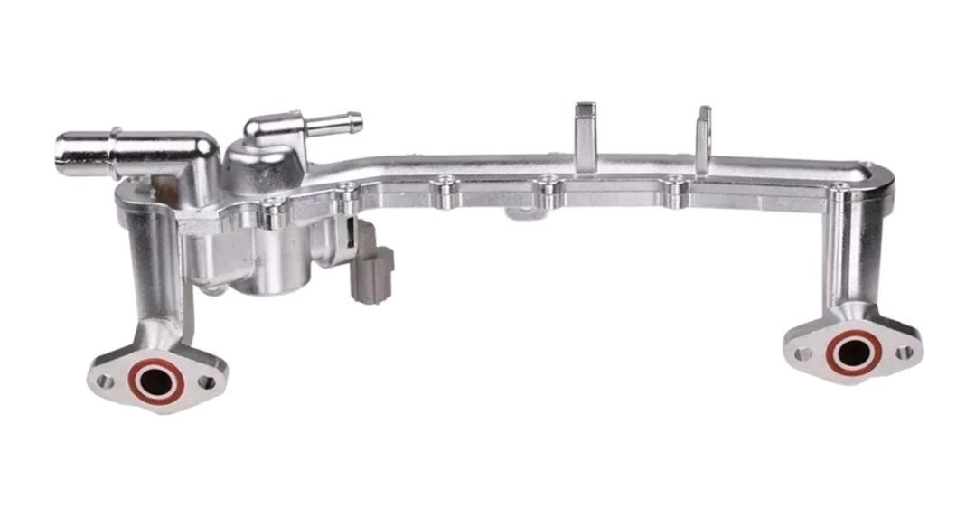

Has anyone installed one of these rear heater tubes on their vehicle? The specialist I use said he's installed 2 and they both came back with issues and leaking, so he won't install them anymore since it's so much work to replace them (on an SC engine, at least).
Curious about the general consensus. Strangely, they're almost entirely available on eBay and not many other places, which makes me believe he's correct and the factory plastic tube is a better part.

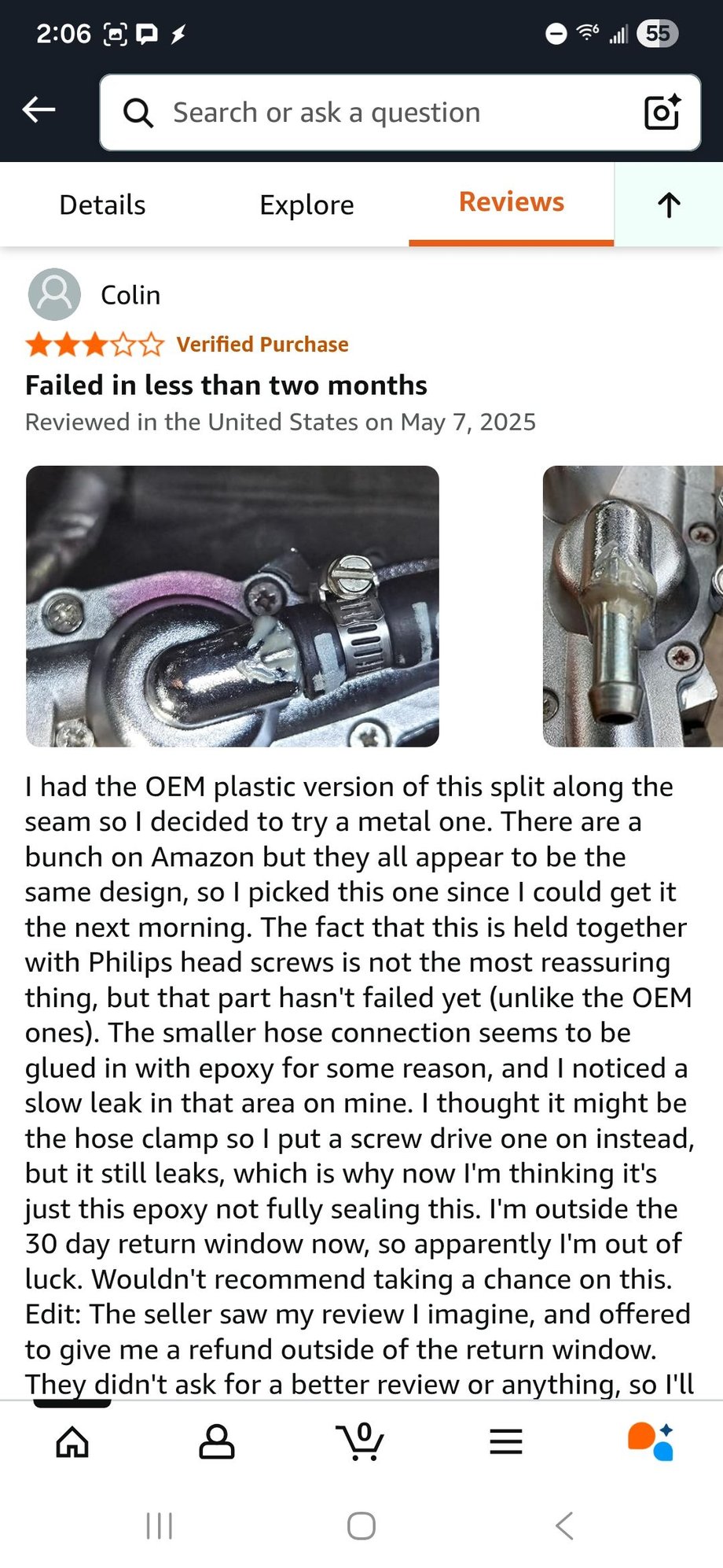

One of the more thorough reviews from one of these listed on Amazon Canada:
I had the OEM plastic version of this split along the seam so I decided to try a metal one. There are a bunch on Amazon but they all appear to be the same design, so I picked this one since I could get it the next morning. The fact that this is held together with Philips head screws is not the most reassuring thing, but that part hasn't failed yet (unlike the OEM ones).
The smaller hose connection seems to be glued in with epoxy for some reason, and I noticed a slow leak in that area on mine. I thought it might be the hose clamp so I put a screw drive one on instead, but it still leaks, which is why now I'm thinking it's just this epoxy not fully sealing this. I'm outside the 30 day return window now, so apparently I'm out of luck. Wouldn't recommend taking a chance on this.
Edit: The seller saw my review I imagine, and offered to give me a refund outside of the return window. They didn't ask for a better review or anything, so I'll give them some credit for that. To give them another chance I ordered another one. The problem area on the new one looks much better.
It still seems to be epoxied in, but it is not gooped all over, and so far has not leaked. However, while I was swapping it I noticed the o-rings on the old one had sort of melted, which is not a good sign after only a few months. They were still holding up, but I don't know for how long. I bumped up my review one star, since it does seem to have fixed the problem with the new one, but I'm still not that happy with the overall quality.

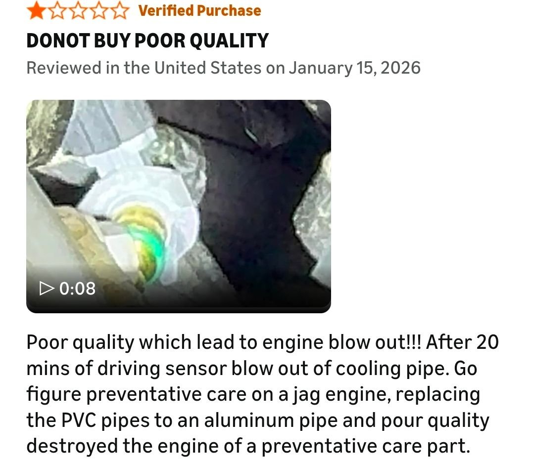

Another Amazon listing shows the sensor blown out of the casting. Seems that for every few good reviews, there's a few bad ones as well. I think this answers my question, since they all seem to have the glued in pipe bung and temp sensor design.
Poor quality which lead to engine blow out!!! After 20 mins of driving sensor blow out of cooling pipe. Go figure preventative care on a jag engine, replacing the PVC pipes to an aluminum pipe and pour quality destroyed the engine of a preventative care part.

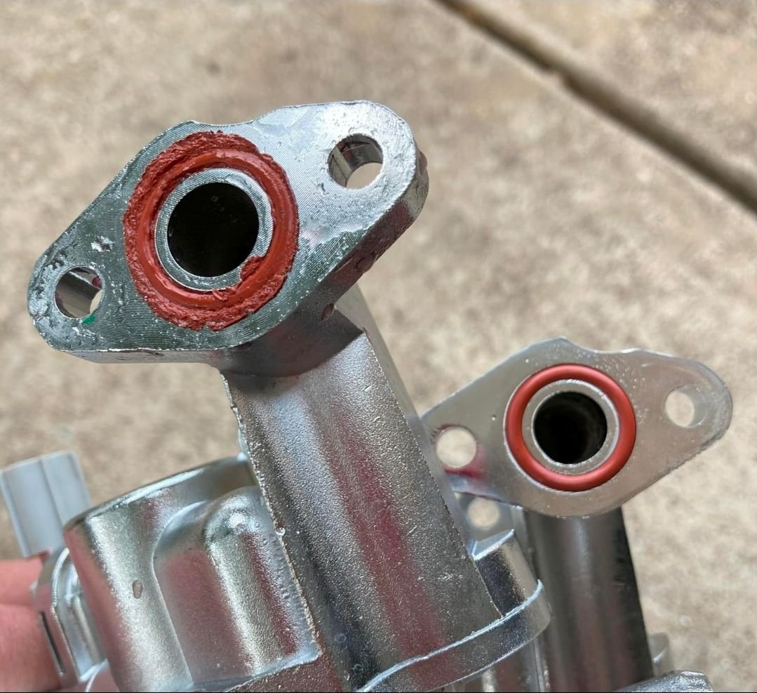

Another review with a video of leaking at the seam in the part. This design looks to have the hose bung as part of the casting, and a black sensor vs grey... So different design, and different failure. Not great.

Those castings look to be incredibly poor quality.
I replaced my forward cooling pipes with metal ones from eBay after the original plastic ones started leaking. It was a massive PITA, especially the one in the valley under the SC (and in particularly since I was practically one handed after blowing out by rotator cuff).
The new ones started leaking massively quite quickly. Ended up having a local shop replace with real Jaguar parts since I was recovering from surgery. No leaks now. The aftermarket ones showed significant O ring deterioration after just a couple K miles, and never seated quite right.
