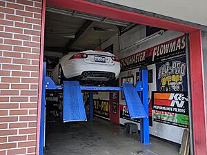

There was one hiccup. After I got the car home I started hearing an exhaust leak. I took it to the local exhaust place, they said no matter how much they messed with the slip joint at the cat they couldn't get a good seal, so they welded them up. They also didn't charge me anything, I will be taking the 68 to them for a new exhaust soon.
