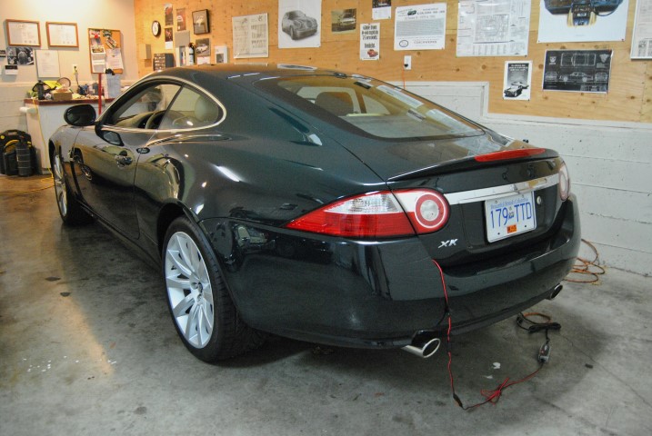

I have to step in here because I hate to see people waste money...you do not need anything more than the most basic CTEK - they all desulphate, they have very slow charge, they all keep the battery at 100% efficiency. I have several of them in use for years. My XK is on the most basic CTEK and it has never given a problem. One thing: the CTEK unit must be kept outside the car so that you can monitor properly; if it is inside then simply touching the latch mechanism will send the CTEK into action and you will always think the battery is discharged or that the CTEK is faulty.
