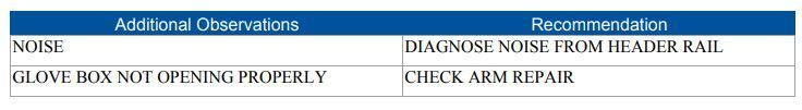

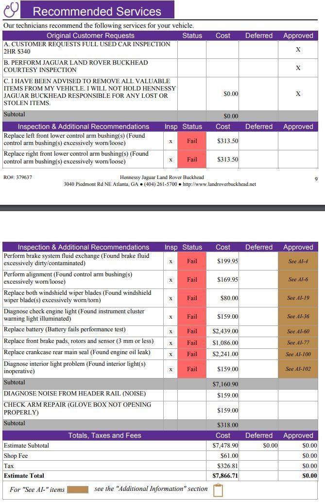

What do you guys think? That price on the battery has got to off (2k???) - maybe a typeo. Also, no diagnosis for the CEL.

Are you hell bent on the year and a vert? You're now up to almost $43,000 with repairs give or take and you can get the work done for less. The battery charge is wrong or should be. The risk is still unknown with the check engine CEL so you still may add on more.

Spot on about everything Sean. I'm looking for 2012 or better (really like the changes made), and I'm willing to walk away from this (too many unknowns right now with the CEL).
The Jaguar dealer had a typeo on the battery and updated the report ($379, which still seems pretty high to me), for a total of $5,418
I sent the selling dealership an email with the findings, as well as my concerns with the 4 diagnosis that still need to be done (CEL, interior lights, noise in header, and glove box). If the seller is willing to get the repairs done, then I'll fly on down, otherwise, I'll keep loving my 07 XK !

More like the dealer drove it like he stole it, and finally decided the cost to fix everything exceeds the value of the car.

Actually, it doesn't look all that bad. Atlanta Jaguar is proud of their time! The dash light could be due to the dodgy battery. At that age and mileage, the suspension bushings are frequently (normally) dying anyway. A brake flush is supposed to be done yearly and I'd bet it hasn't. Stop at Pep Boys for wipers, they'll even put them on for about $30. Get a battery ($180) there while you're at it. The dash drop thing has been addressed on the forum several times and is a free fix. A set of front brake pads and brake flush will be around $300 at any indy shop. The noise in the top rail could be entertaining to track down though. Just my thoughts flawed as they may be.
