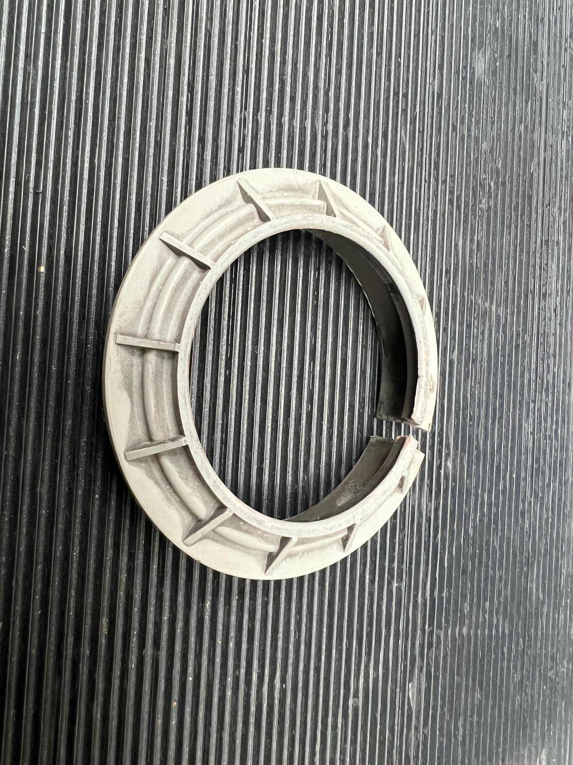

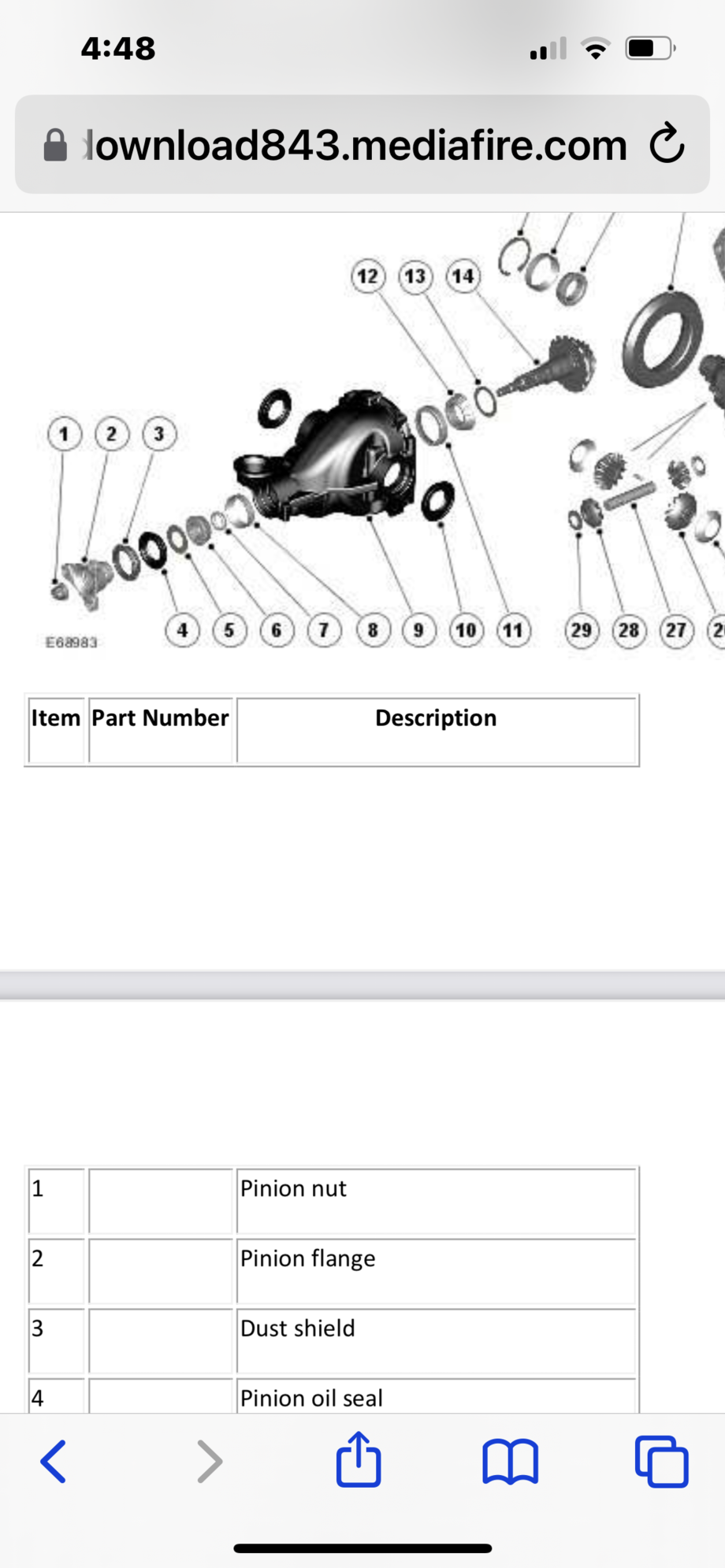

I had a annoying noise that would randomly start and stop at various speeds.
It took me awhile to find it. I had the car on my lift for a oil change and spotted the problem. The dust shield on the differential was cracked and loose. It would start spinning with the driveshaft and sent a humming noise through the car.
Dust shield

Does this require a lift or any disassembly to remove the dust cap? I'm having the same issue.
Thanks!
You will need to jack up the car high enough to slide under and pull it off. Nothing needs to be removed to gain access.
Understandable, but surely you need to disconnect the drive shaft to install a new one?
I live in Las Vegas. I put about 1000 miles a year on it running errands. I have other vehicles and have never driven it in the rain. I haven’t worried about replacing it.
If a new one doesn’t have a split in it you need to drop the driveshaft.
