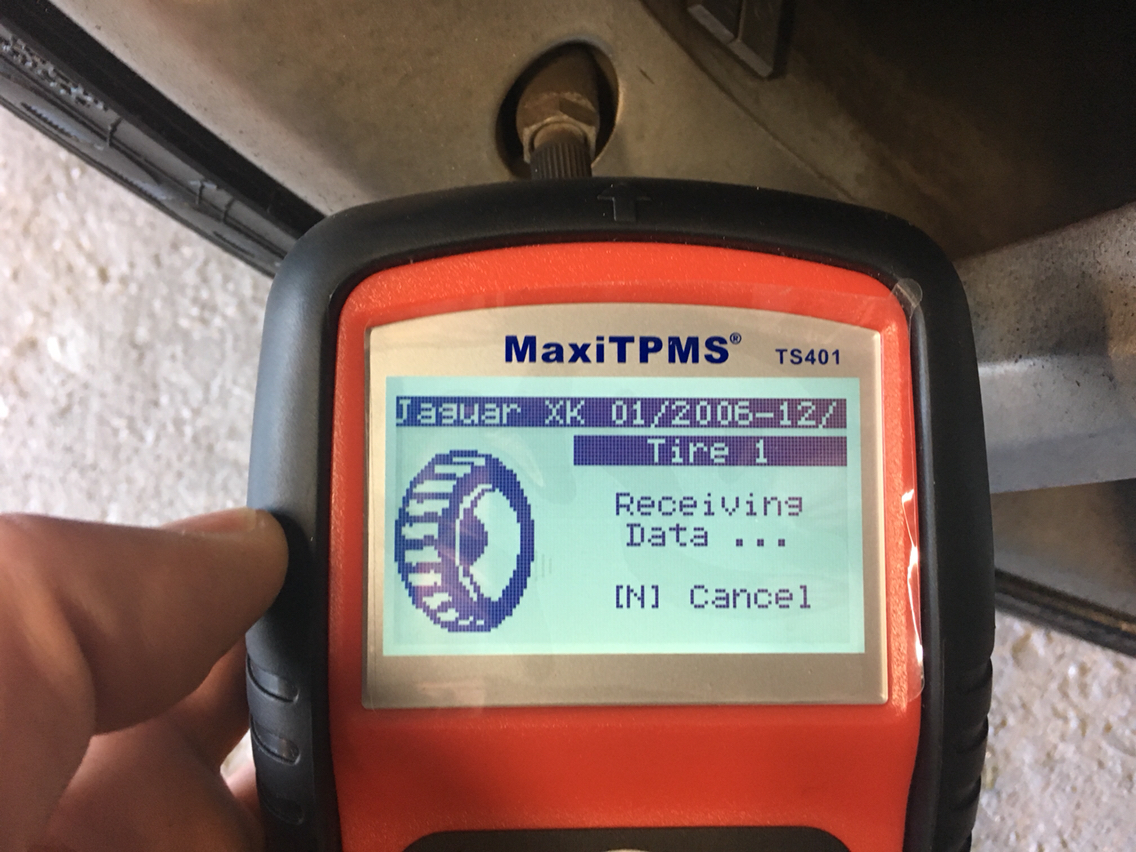

I've got a TS401.
You can read the sensors directly from the wheel, which gives you the sensor ID, pressure, temperature, battery status..
It doesn't actually interact with the car, won't clear codes or fault messages, it won't "pair" a sensor with the car. Maybe the TS501 can do that, as that tool will connect to the car over the OBD port. I didn't go for the TS501 because I have IDS/SDD that covers the car side of things.
