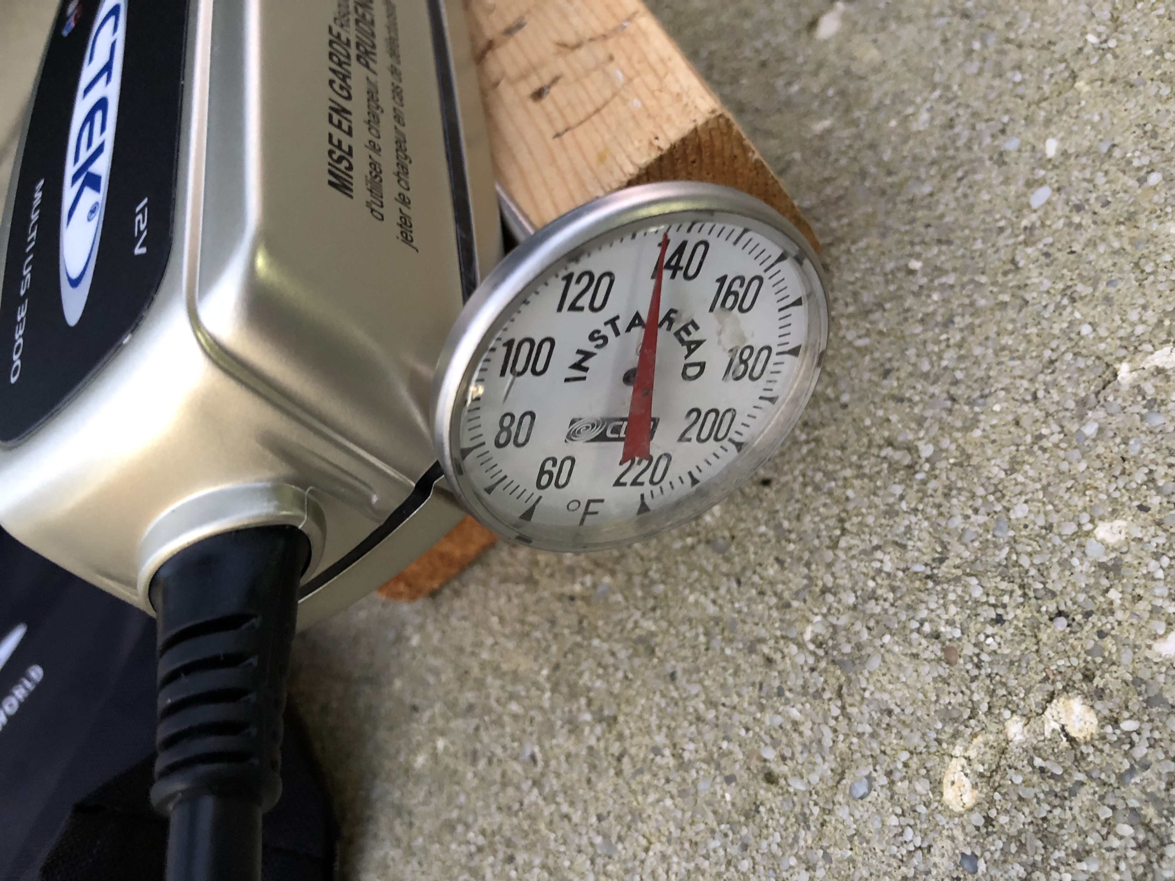

I have recently purchased the CTEK battery tender for my 2011 XKR coupe. I’ve been using it for 3 days now (not nonstop), have driven the car during the same period. I am currently using it with the alligator clips at the +charge post and the neutral in the spare tire well. It has been in the hatch area with the car locked when in use. I may keep the unit outside of the car so I can watch to make sure it is cycling from charge to maintain. As it is now by the time I unlock and open the hatch it seems to always be on charge mode. When I unplug it I see it switch briefly to the green maintain light before going out.
My main question and concern is how warm/hot do these tend to get when in use? This one gets to be more than warm, fairly hot. When using a cooking thermometer, which might not be a totally accurate way of judging, it gets up to nearly 140 degrees.
Any thought? Does it make any difference being clipped vs hardwired?

1st when you unlock the car and open the boot you draw enough current that the Ctek goes back into charge mode. If you leave the unit outside the boot say on the floor it will not change to charge state if it has completed the charge cycle. If it takes a long time say greater then 1/2 hour to go into the maintain state you may be starting to have a battery problem.

The temperature of the Ctek is normal during the charging state. If you drained the battery then the Ctek is not the right charger to restore the battery. You need to use at least a 5-10Amp charger and give it a full charge. Once done take off the chargers and wait maybe 10-20 minutes and then take a voltage test. You should see at least 12.6 Volts at the battery. Anything less is a battery or a current draw problem. I assume you always lock the car when you get out of it.

2011 5 liter. Is the negative bolt in the tire well the one just t the left of the spare, coming up through the floor. We are thinking the tender might not have been getting a good ground. When we put the meter directly on the battery we got about 12.5, but when we tried the meter on the remote posts we got zero. But after using a wire wheel brush to clean off the surface finish on the ground we were able to get the same reading as the battery. Perhaps it wasn’t make good enough contact to ground, and that was making the tender heat up trying to charge? Without an actual meter on the tender I guess there isn’t a way to tell if it’s actually charging unless the lights switch to green, maintain.

OK yes that stud in the spare tire area is good for a ground and yes you need to clean it to make sure you have good contact. As for the battery 12.5 V looks good as an at rest voltage. The Ctek will charge and hold a float voltage once the battery is a full charge. The lights will stay on so take a few minutes to read the Ctek OM. Enjoy

Thanks to everyone for their input. The tender did switch to green maintain last night and the unit did cool down considerably so cleaning the paint finish of the remote ground helped. I finished reading the 17 pages of posts on the CTEK thread originally started by Richard in 2013 which had much needed information, and as soon as my CTEK comfort connect extender cable arrives I will hardwire to the battery using the positive post and the recommended ground location before the battery module.
