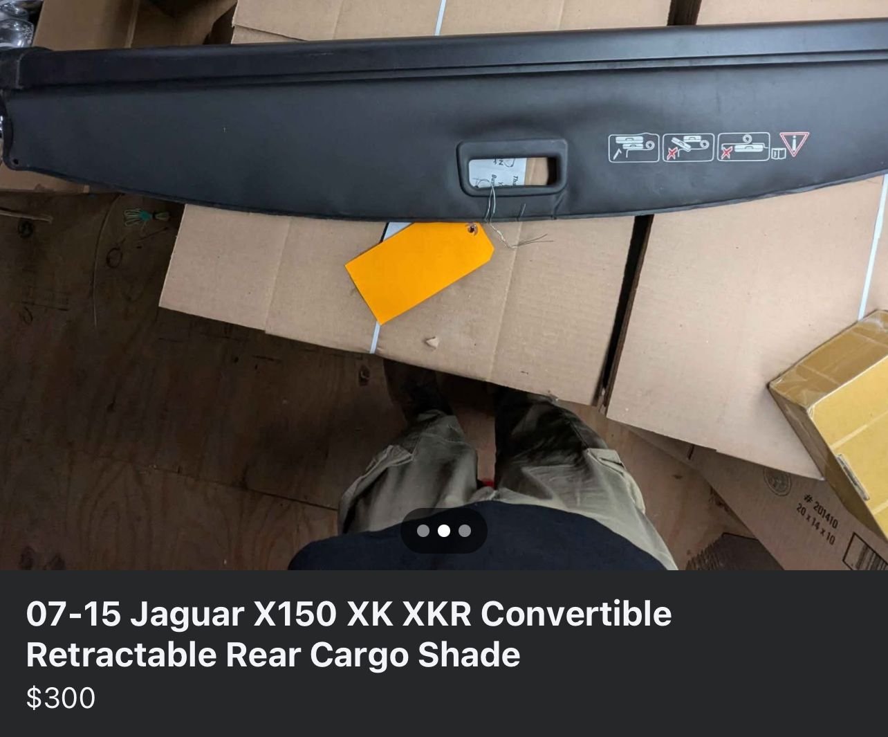

Check FB marketplace. There is a used one for sale an hour from me for $300 obo.
Be sure to be creative in your wording.
This person called it a retractable rear cargo shade.
lmao!
