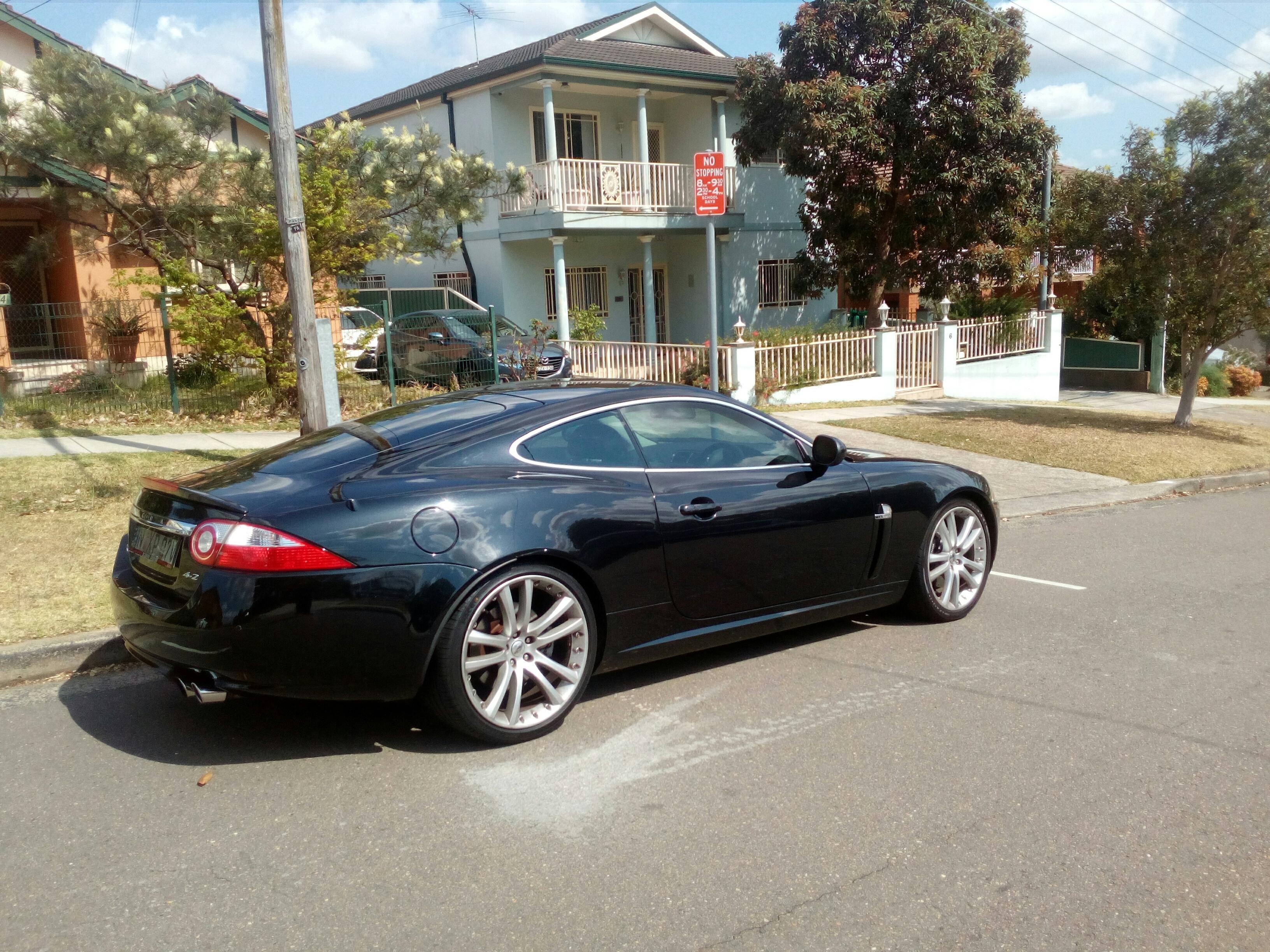

Originally Posted by peterv8
Do you have a picture of your lowered car? I'm curious how it looks with Adamesh springs as I've bought a set too but not put them on the car yet.:-)I think you should go for Spires springs, they only lower around 18-22mm.
Eibach springs 20mms drop
Attached Thumbnails Anyone Make Universal Urethane Spring Spacers/Isolators?-img_20170920_110453.jpg   Anyone Make Universal Urethane Spring Spacers/Isolators?-img_20171108_084723.jpg
