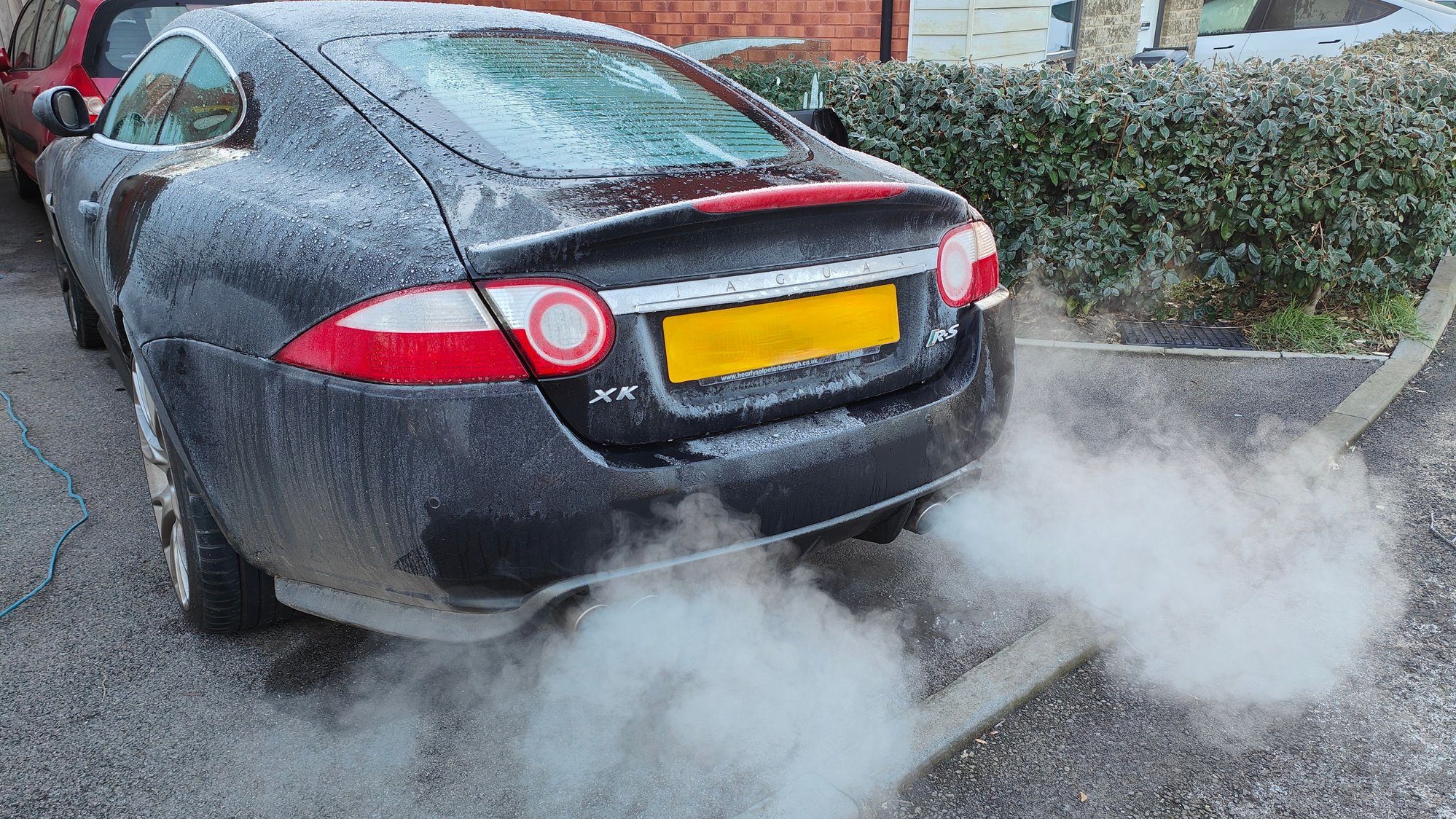

Alcons were first fitted to the 2008/09 XKR-S - limited to 200 units, the USA portfolio spec got some of the XKR-S bits like the brakes - The XKR-S is rare, when you select your vehicle here there is no option but the later facelift XKR-S
This car is a machine, I was a couple of years looking out for one and I will keep it as long as I can

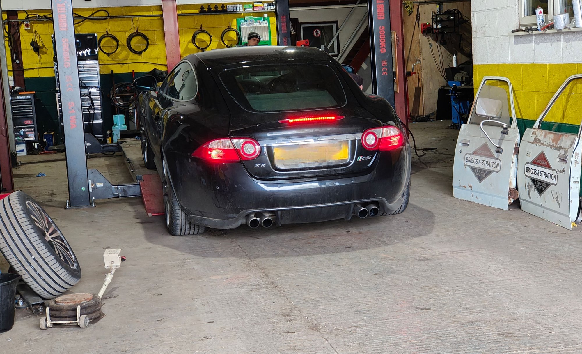

The XKR-S of mine was the first model fitted with Alcon brakes, they were an option after this on other Jaguar XKs along with the forged vortex wheels and the larger rear spoiler.
