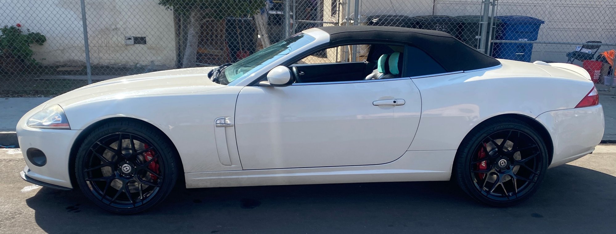

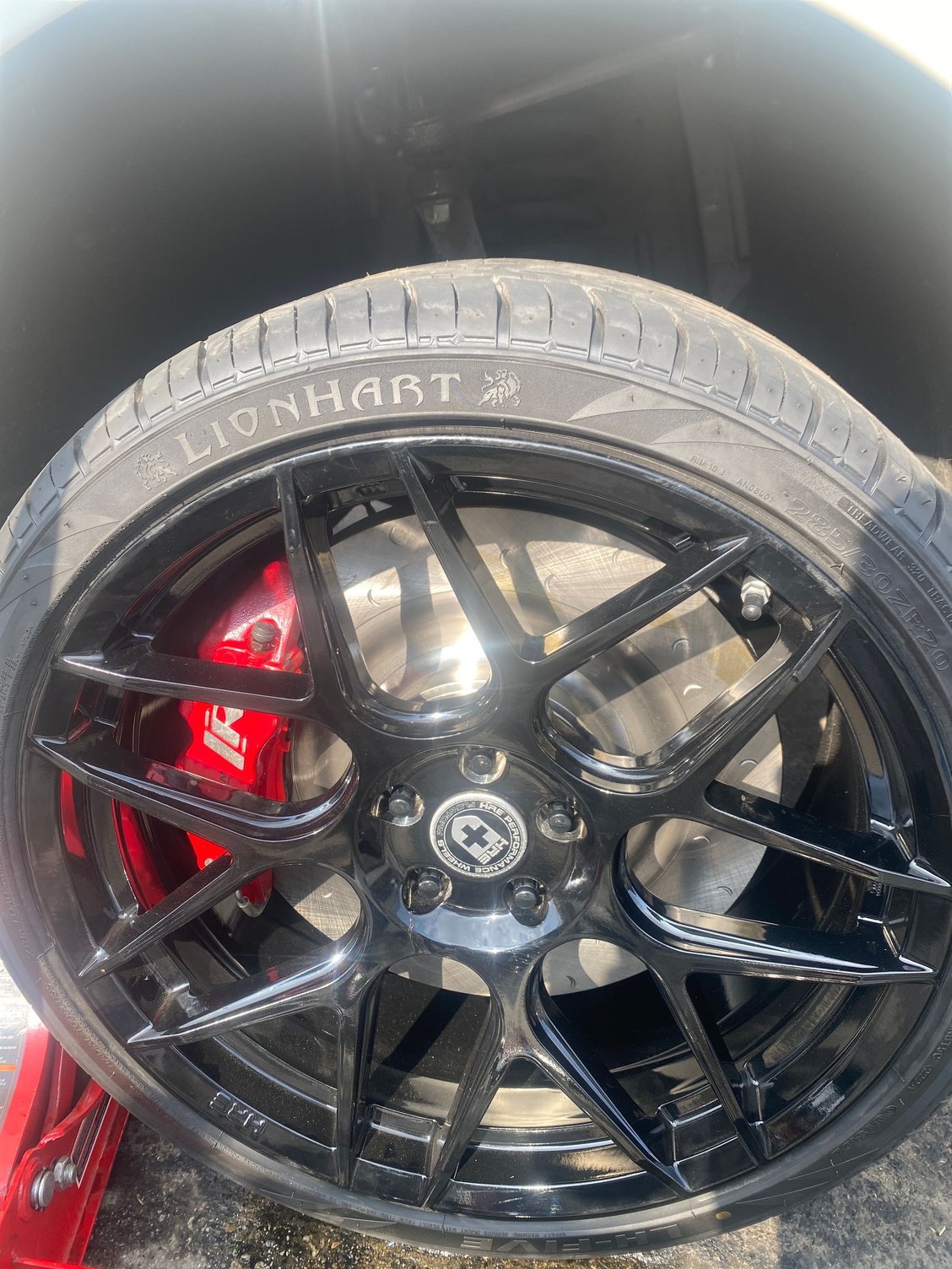

Despite being unable to mount the Alcons, I mounted the HRE wheels. They have sufficient clearance for the Alcon calipers

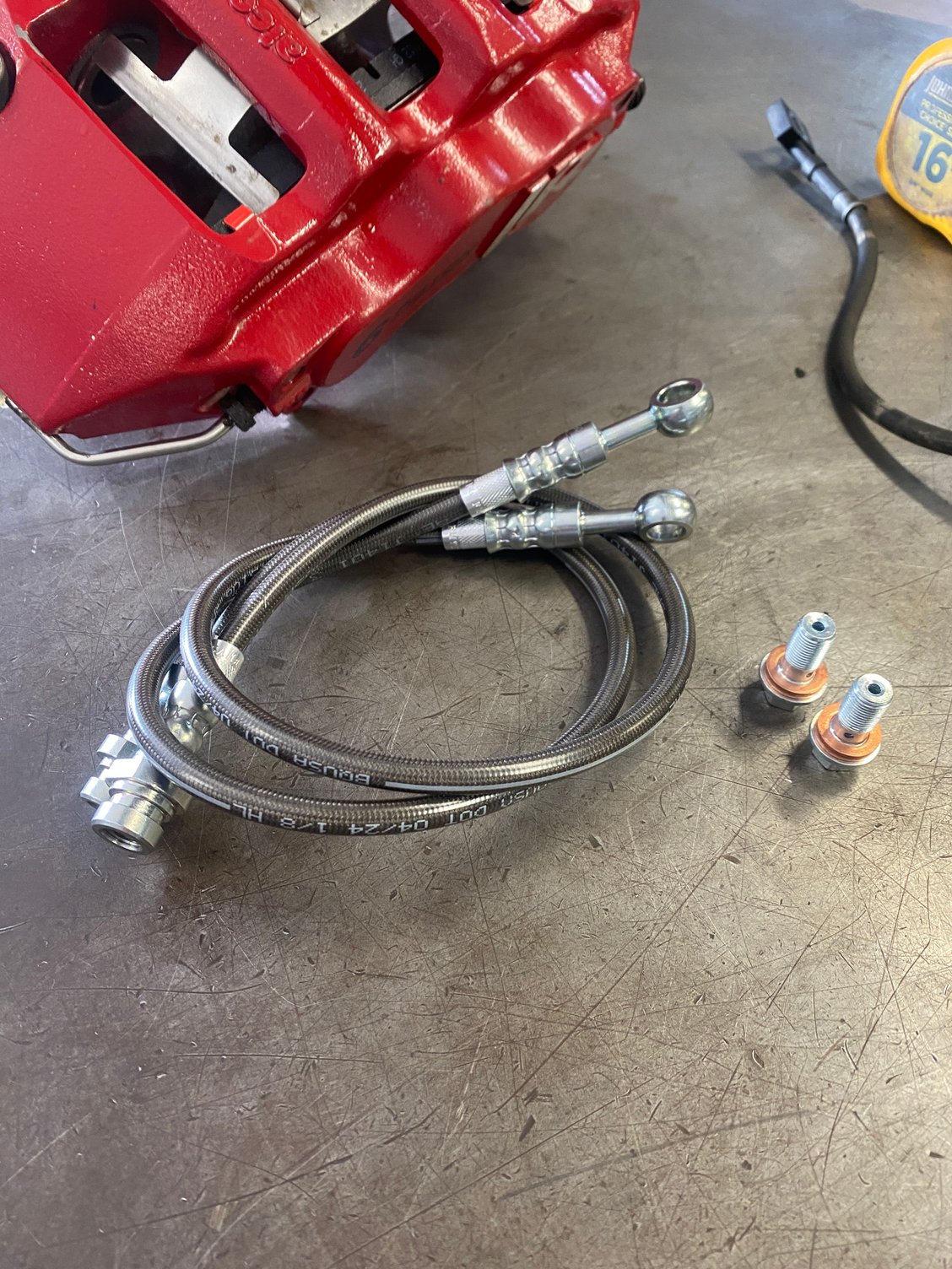

I was able to source a manufacturer thst is making custom steel braided hoses as I type this. I should be able to start project again in the morning

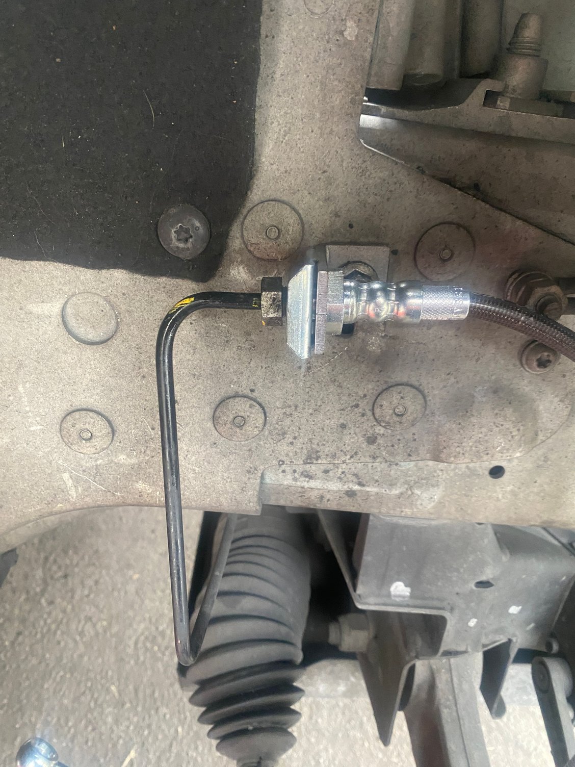

Brake line installed with manufacturer supplied hardware

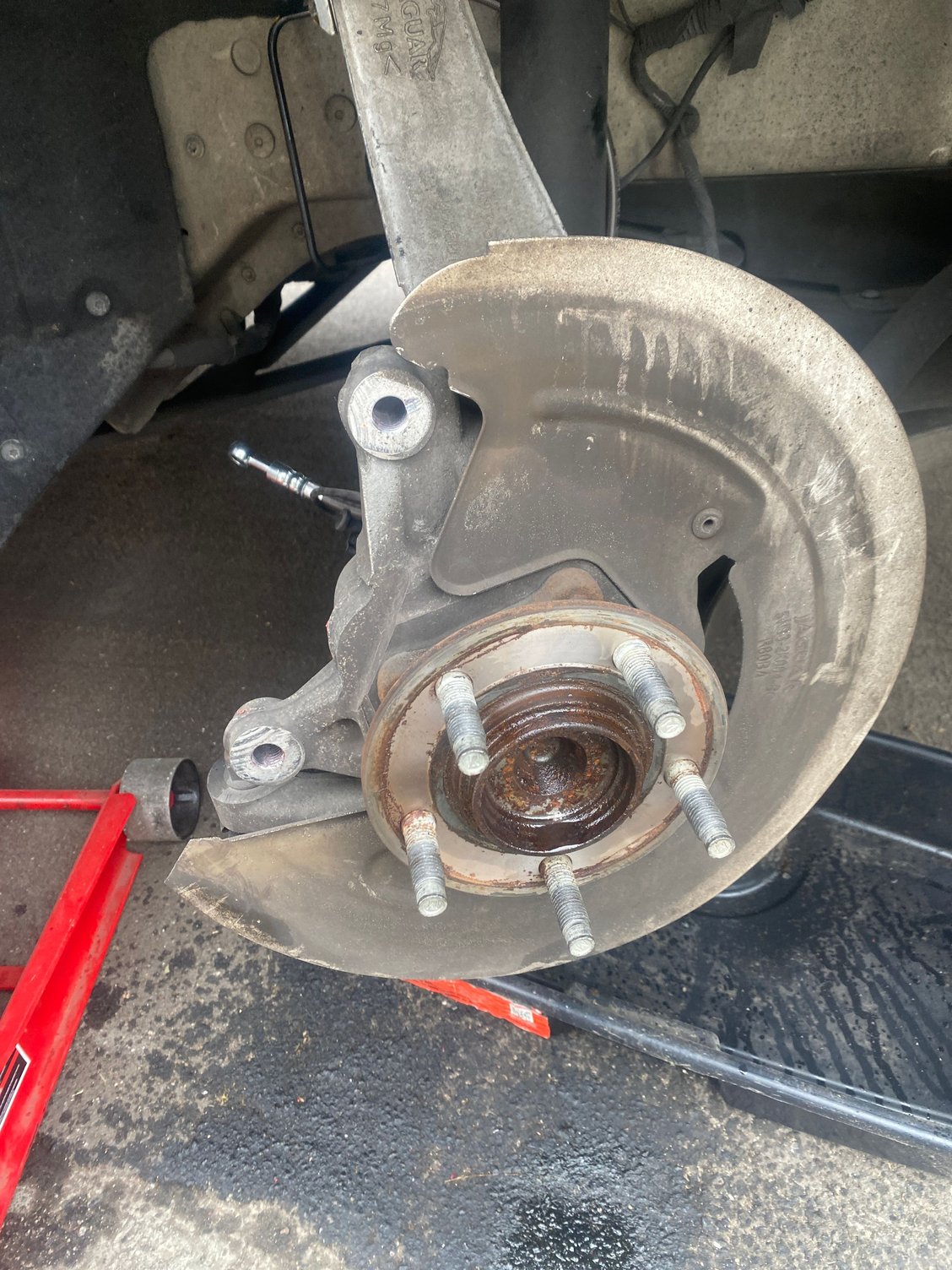

Disc brake removed. Took a 7 ton claw puller. Tried weighted mallet, blow torch and WD 40! Nothing worked

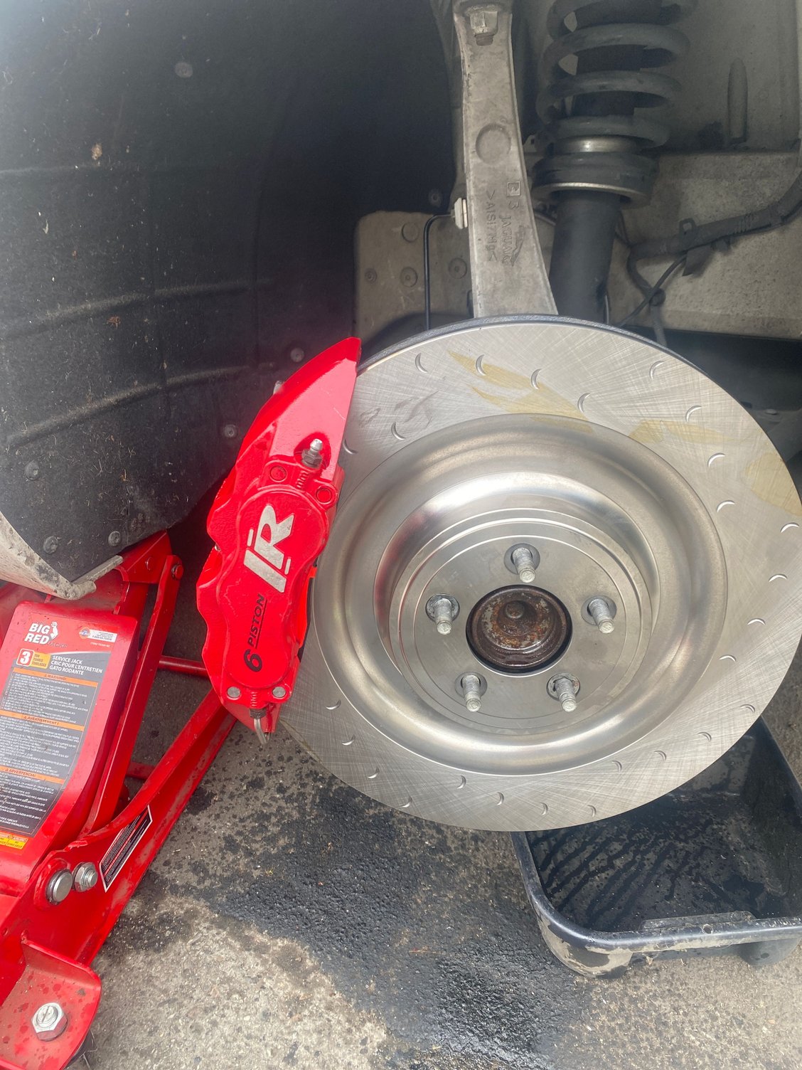

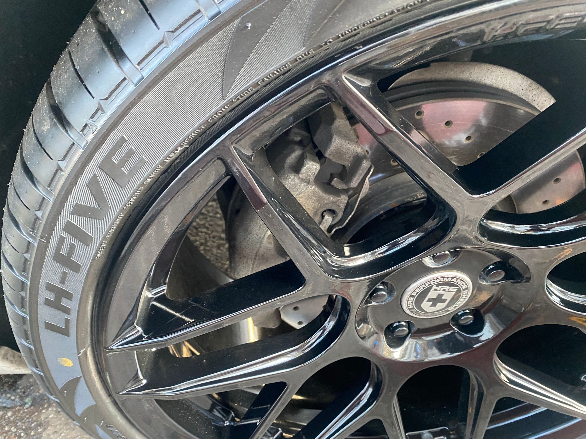

Caliper and disc installed. Slow progress but nevertheless PROGRESS

It looks like you painted over the "6 piston" decal.
I couldn't find that decal. If that's important to you, you might be able to have it custom made. I found this on Etsy:
Custom Made Brake Caliper Decals
