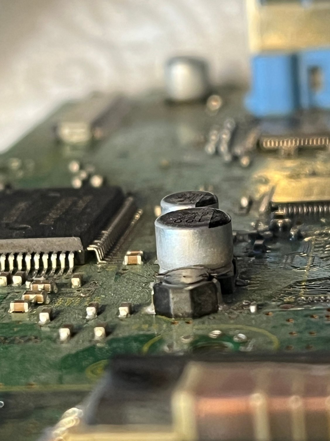

Thanks for looking that up! You may be right as that doesn't look that different from a new inductor. What came off was a small bit of plastic, but the wires appear attached.
Old Mar 29, 2026 | 10:26 PM
  #283
billqs's Avatar
Joined: Mar 2019
Posts: 191
Likes: 62
From: Birmingham, Alabama
Here’s piece that broke off. Now that I know what the new piece looks like I’m not so worried.

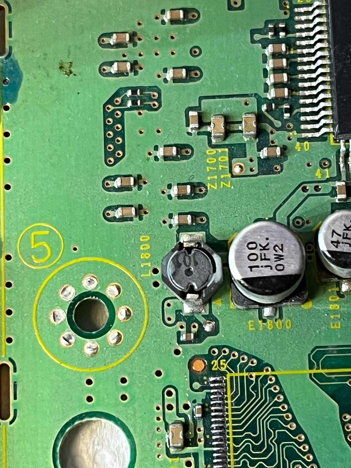

Here it is… (It is connected to both sides, but it does move about a bit... EDITED: There's no continuity between the two raised solder pieces that the wires are attached to. And now the piece is not attached.
Old Mar 30, 2026 | 06:09 PM
  #289
billqs's Avatar
Joined: Mar 2019
Posts: 191
Likes: 62
Thanks to Sean W.'s help, I've found a replacement screen assembly and have ordered it. While a person with really good soldering skills could probably resolder either that piece or the inductor replacement piece which is really inexpensive, a person with my soldering skills could not.

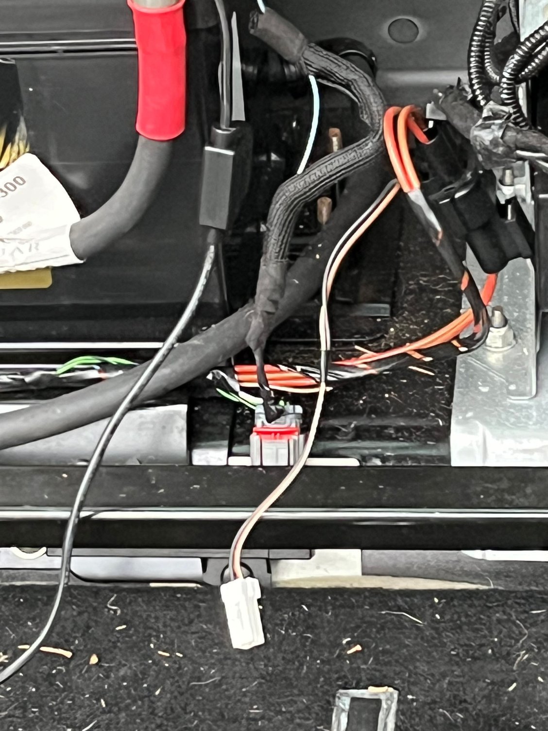

BTW I found what appears to be an extra power connector out in the boot as I was tracing the MOST network. The connector looks just like a speaker connector. Nothing is missing a power connector as far as I see. Any help here would be great as well.
Old Apr 6, 2026 | 08:12 PM
  #294
Cee Jay's Avatar
Joined: Apr 2013
Posts: 11,906
Likes: 6,417
From: Kaysville, Utah, US
That extra plug in the boot is a Shipping Relay connector that was used to ship from the manufacturer to wherever it ended up. Not used afterwards.
