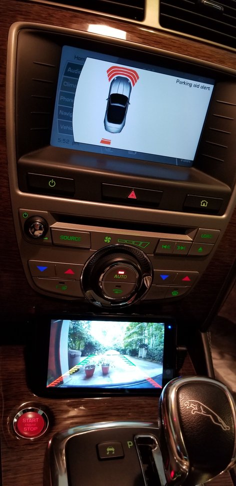

See my Post #11 in this thread from 2024 for details of my solar-powered, quick and easy to install wireless backup camera: https://www.jaguarforums.com/forum/x...camera-279946/
It's an old photo but it still works great. I like it because it fits perfectly in the ashtray, works together with the factory system, has moving and color-coded grid lines, and meets my needs with no modifications to the interior.
P.S. Search Amazon for similar backup cameras.
