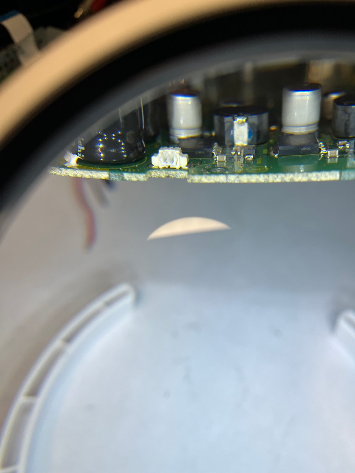

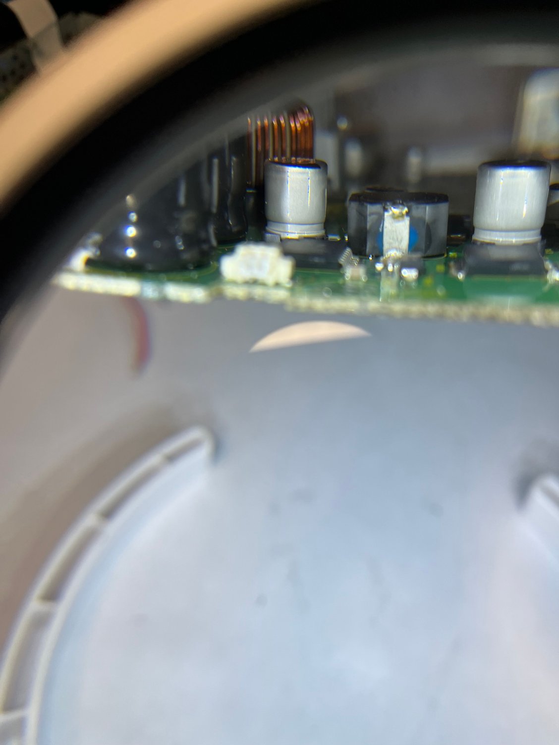

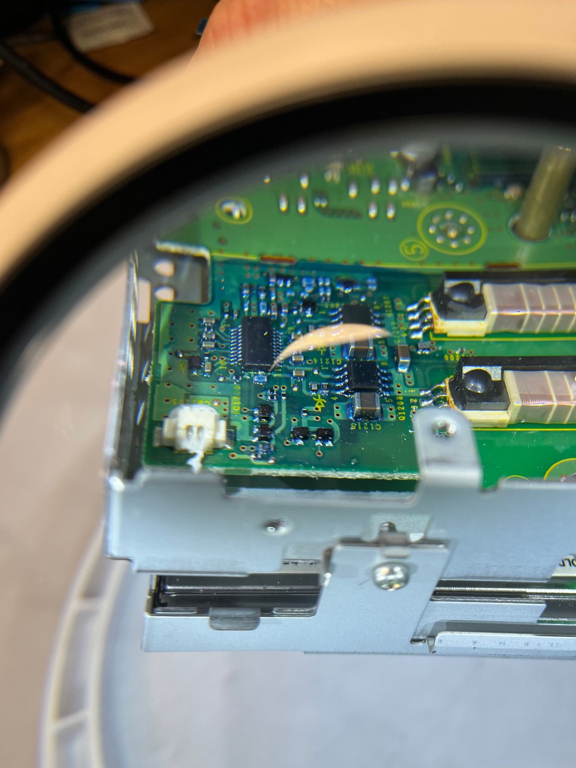

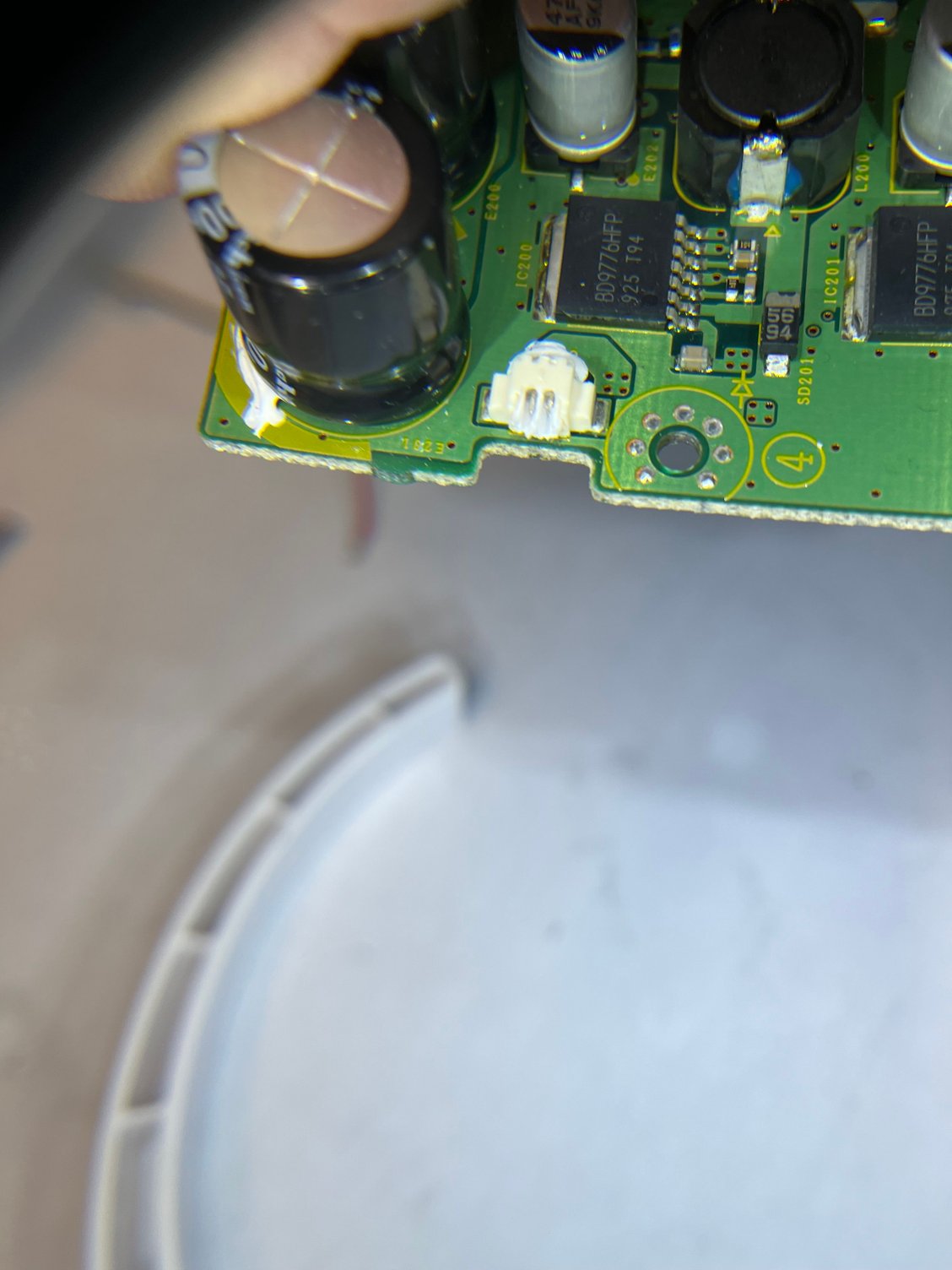

Default Help! Power cable connectors broke can’t clean out socket
Ok, so I’m working on the Mr12volt kit and I get to the part where you are removing boards to add the new video board. When I tried to disconnect the power cable on board 1 or board 2 the connector fell apart , and part of the connector remains in the socket on each board. I can’t seem to remove the bits of the connector so I can plug in the new power connector.
anybody DY got any suggestions? Thanks!

Originally Posted by Simon Tan
Of course, I immediately ran into one of the problems he described which was an internal power connector that crumbled in the course of being unplugged. But this turned out to be a non-issue since the broken cable and connector are replaced by a new one anyway.
Just for clarity's sake, this is where I am stuck. Unfortunately, when my power cable connector crumbled the side and bottom are still stuck in the socket. I have tried to clean it out with an exacto knife, tiny screwdrivers and tweezers, but so far no luck. I quit in hopes I could get some help before I permanently ruin the socket and have to get another OEM screen unit. Could the connector be locked in some way?
While the install video for Mr.12Volt is great, and there's no problem with the kit, the video runs kinda fast through some areas like this that really need more amplification so they can be successfully done.

I would try nibbling the broken pieces with a pair of side cutters preferably a small pair, a small pair of needle nose pliers might help too.

I finally got it. Had to get a pair of incredibly thin needle nose pliers and it eventually worked!
Thanks for everyone's help once again!

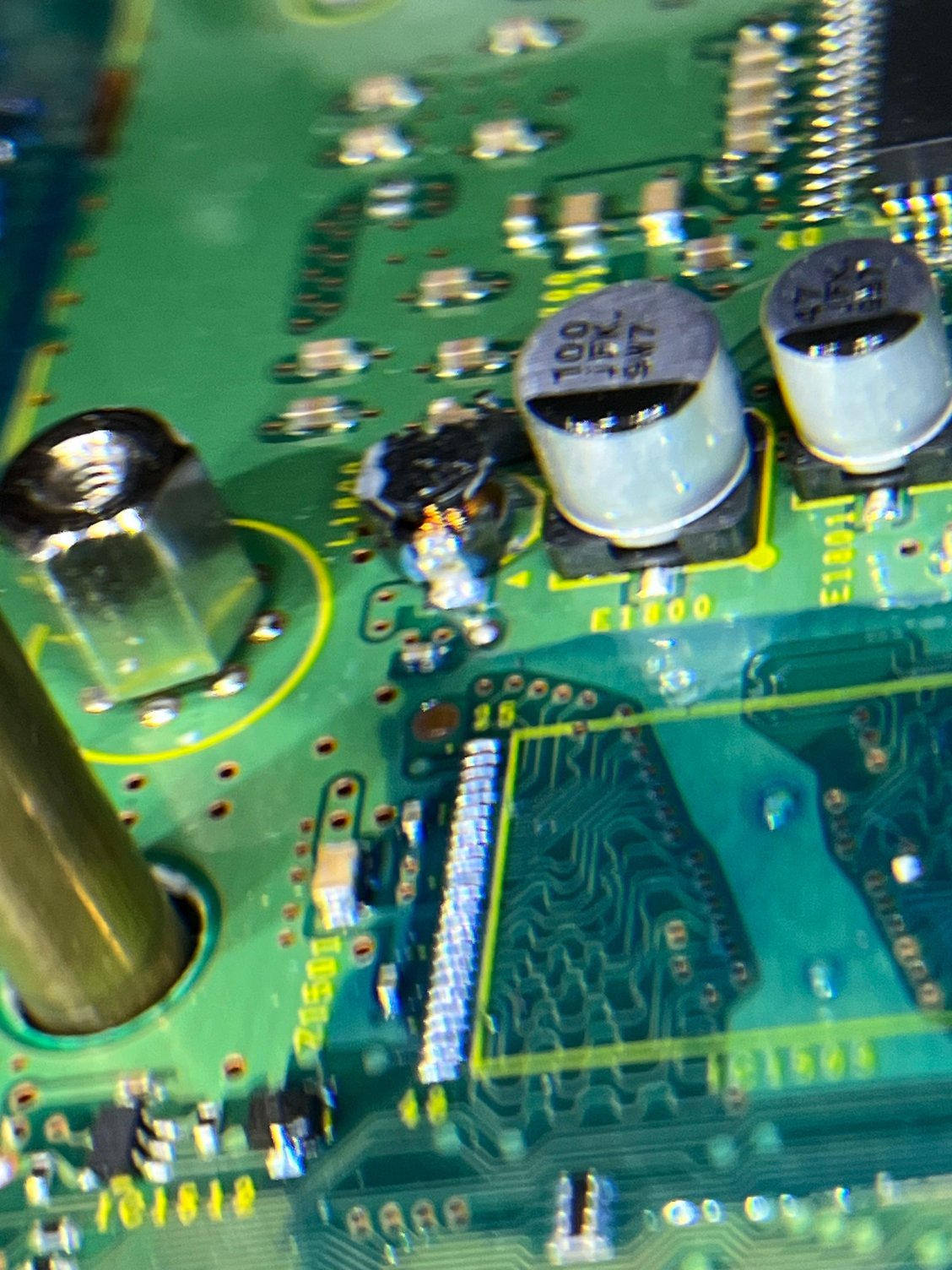

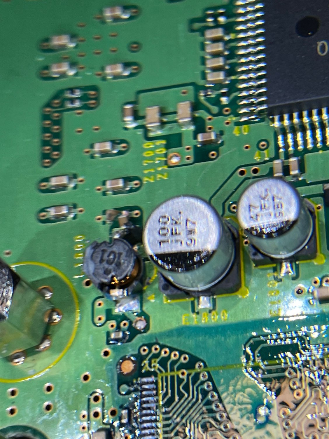

Well, this time I think I’m toast. When tightening the standees for the new board the pliers grazed a capacitor labeled 101 and it disintegrated. Does anyone know the value of it?
Edited to add:
Might be a coil instead of a capacitor. It's still hooked into both solder points, its just the plastic casing that fell apart.
