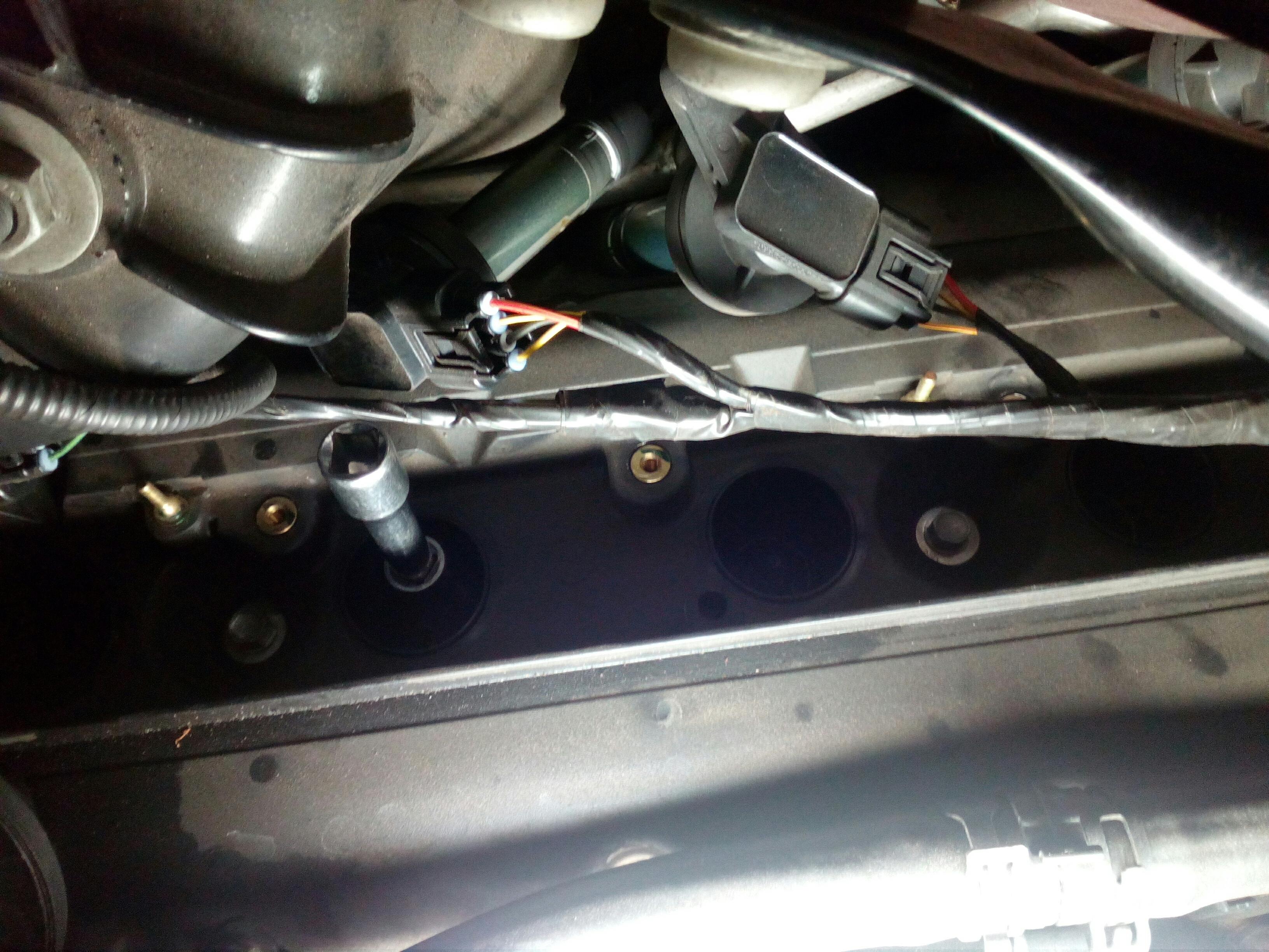

Just fitted up a set of (cooler) that is aston spec'd plugs
Attached Thumbnails Aston spec'd plug-img_20170402_190534.jpg   Aston spec'd plug-img_20170402_190826.jpg   Aston spec'd plug-img_20170402_190817.jpg

How much fun was the left bank?
Old Apr 2, 2017 | 05:58 AM
steve_k_xk's Avatar
Joined: Jun 2015
Posts: 3,001
Likes: 1,674
From: Sydney, Australia
Cylinder number 2 was a little tricky with the dipstick and #8 due to lack of space but overall it was pretty straight forward

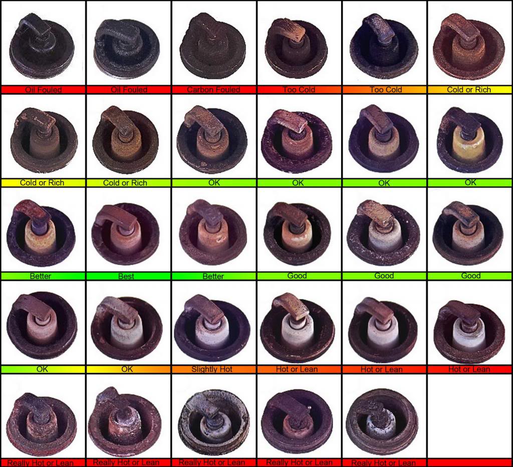

Picture not too clear to make out but "looks" like it might be normal especially if the "white" is really tan. Your insulators are really clean too, the ones I pulled from the Super V8 at around 60K were well corona'd.
Old Apr 8, 2017 | 08:11 PM
steve_k_xk's Avatar
Joined: Jun 2015
Posts: 3,001
Likes: 1,674
Going off the pics we pretty much land in row 4
The Ok to lean/hot varieties
