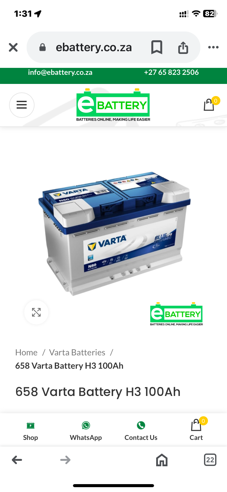

Posts: 421
Likes: 89
Originally Posted by Kjeld
Lol, man enough! I hope so too.
this pic is what’s fitted I think 100ah. This is the Blue I think there’s a silver too. German but only a 2 yr warranty! Will report back after a few months or sooner if there’s an issue

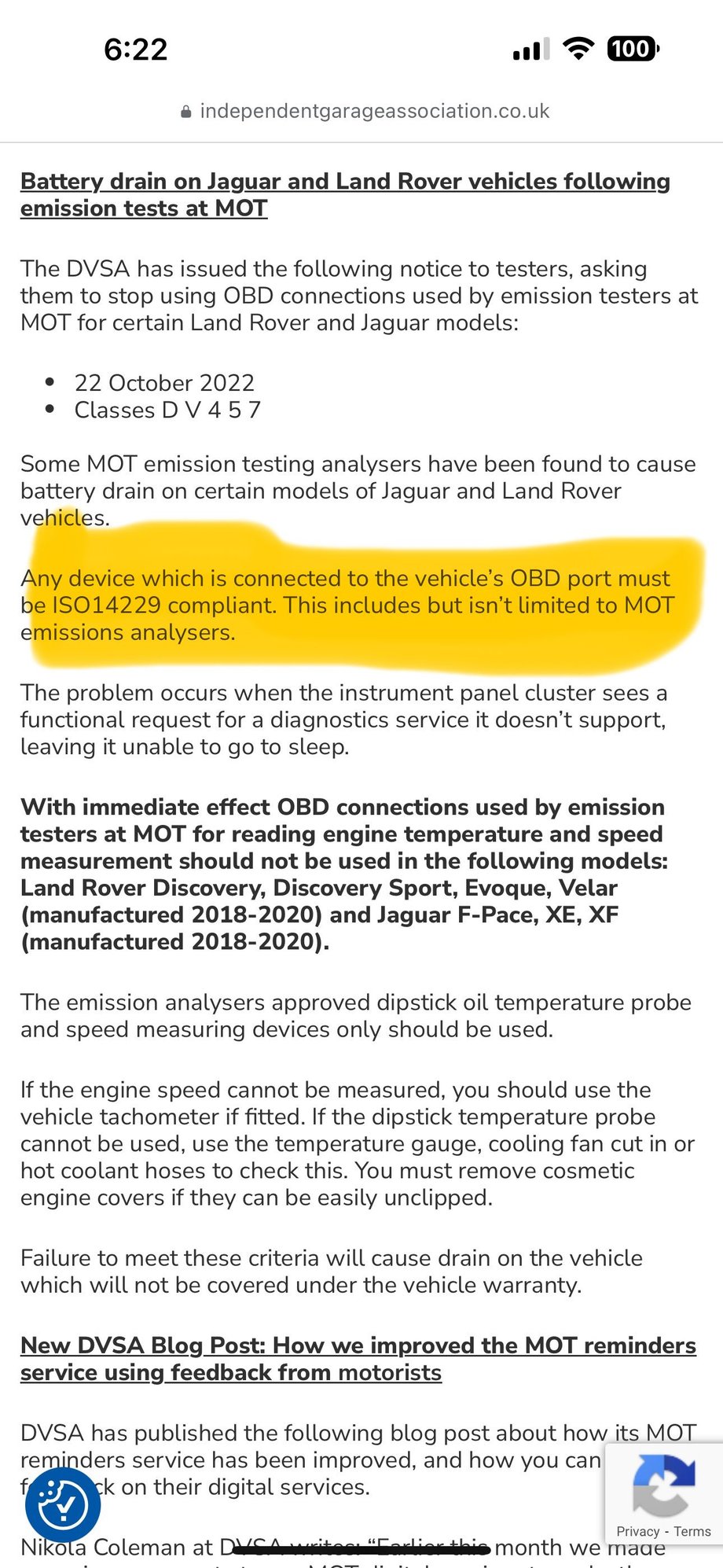

I have a 2018 f-pace 3.0, and have been looking at scanners. I came across this document on a forum (maybe this one…).. foxwell says their 909 and 1009 support this standard…not sure about the 710

Glad to see the UK authorities have recognized this and issued a warning to make sure all devices are ISO14229. Whatever that is!
Now I will need to check and see if the code readers recommended have this rating.

Jaguar need to fix their devices!
What a farce.
This is an example of MoT doc

are you requesting that a vehicle pre 2020 be updated to support a 2020 directive? At whose cost?
Moreover, this theme of “battery drain” is grossly over exaggerated… I can explain why all of my modern JLR vehicles can sit for 3 months and still start on demand; The batteries are in a good state of health. There is no maintainer attached.

Not asking that but an OBD command should never affect a vehicle in the way described (i.e. failing to go to sleep).
That's a serious defect no matter when.
Obviously with JLR's troubles they won't fix anything. At least, probably won't.
