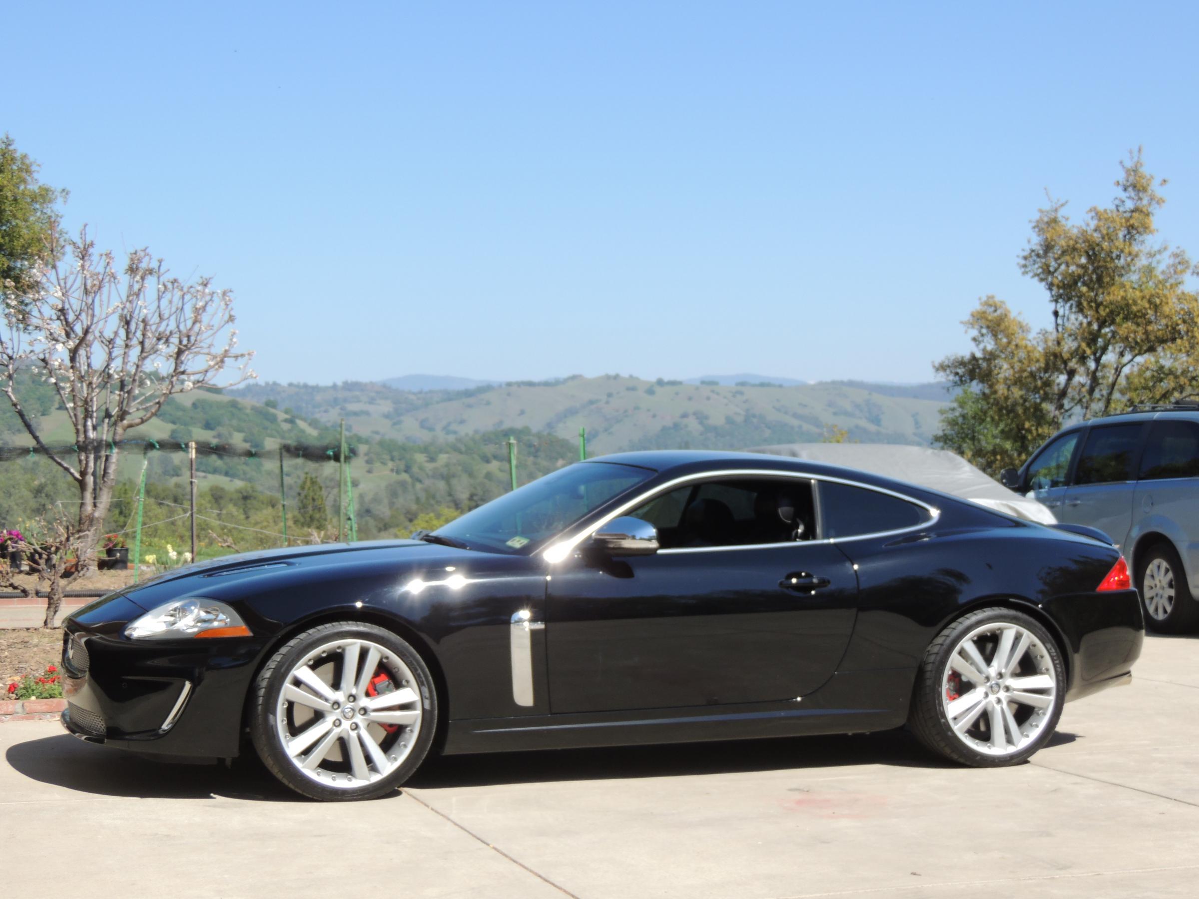

Stock wheels, tires sizes and ride height for my '10 XKR.
Measuring from the pavement to the highest point in the wheel arches (to metal fender edge on the back):
Fronts = 27 3/4"
Rears = 27/ 7/8"

I am not certain how accurate that is due it variances in tire inflation & tread depth but here are mine:
Rear Right & Left: 28.25
Front Right: 27.75
Front Left: 28
Close to yours, but not the same.

OK for my 2012 xkr convert
Fronts = 28"
Rears = 27 3/4"
OEM Dunlops 10K miles on them.

So your's is a full half inch lower than mine in the rear while the fronts are about the same.
Now that we have started this, it would be interesting to sample other members' cars. This may confirm what I was told by one of the UK spring manufacturers last year, when I was searching for 20mm springs, that lowering springs should not be guaranteed with a specific height reduction as no 2 XKRs are the same both from the factory and over time.

Something didn't smell right here so I just measured the rear tire diameter and it looks like 26 1/4" . This is for the OEM Dunlops at 285/30-20 and if I look at the tire spec on tirerack it says the tire diameter should be 27". So based on that my gap would be 1 1/2" (27 3/4 - 26 1/4) for the rears. I did not do the fronts but I suspect the gap should be about the same or a hair larger due to the difference in tire diameter.
