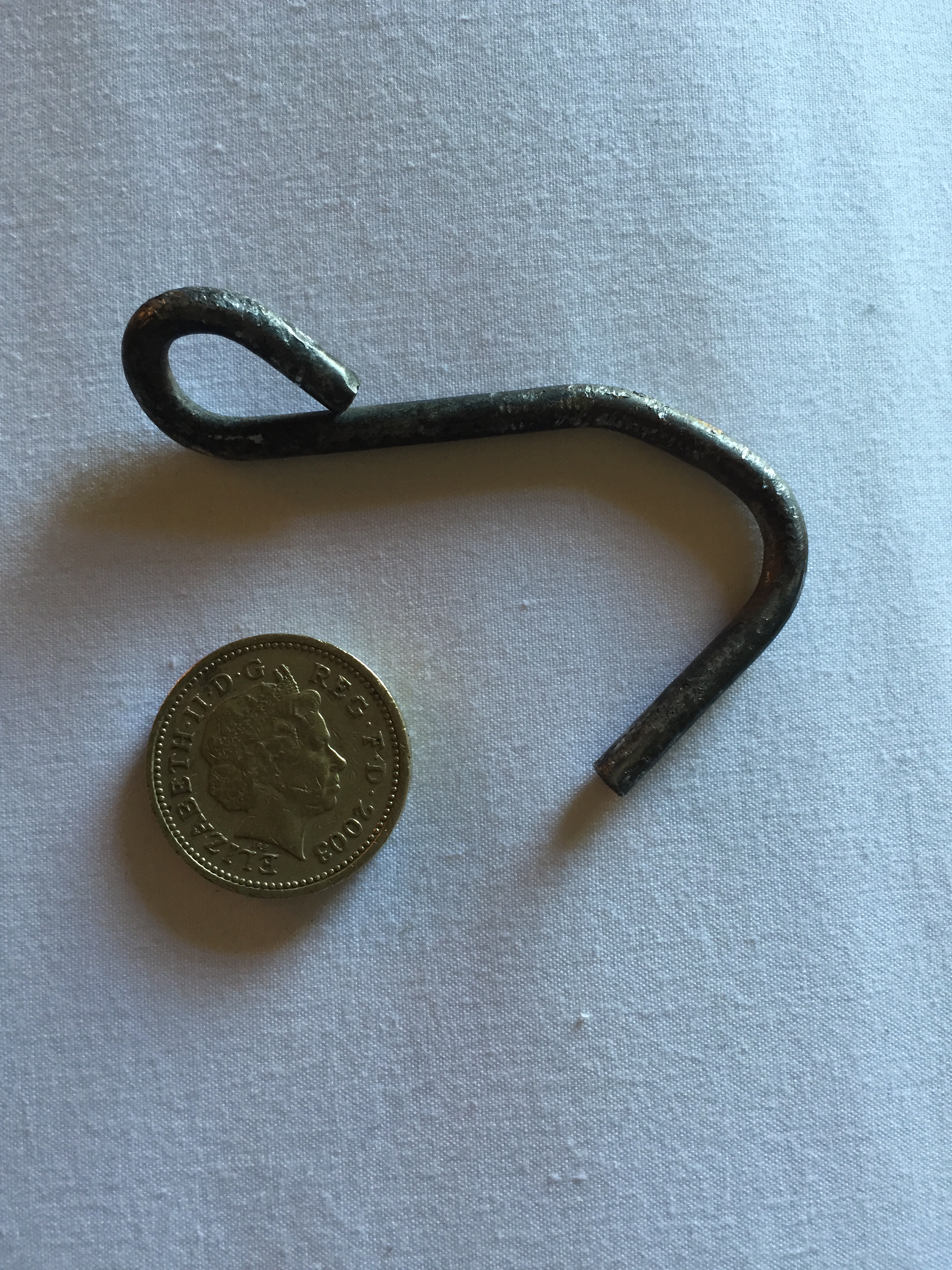

On inspection, I found this little farquhar stuck into my almost-new rear Pirelli 305/30:
Hmmm... I'm out in the sticks, it's Sunday, and there's a major airshow going on a few miles away so any low-loaders in the area are likely to be tied up up with people who've overheated in the horrendous traffic queues.
Fortunately, having seen a bunch of people on the forum mentioning Dynaplugs as part of their flat-tyre solutions, I decided last week to find out what a Dynaplug is. Looked reasonable, so I bought a kit - it arrived on Friday, just before we left for this trip.
I yoinked the offending hook out of the tyre, and we banged two Dynaplugs into the hole - it was still leaking after the first one, so we added another. It wasn't easy to push them in, but our friend managed it; I think I was using the wrong technique. Tested the repair with some dishwashing liquid from the pub kitchen; there was still a very small slow leak, but I knew the tyre would hold pressure for long enough to get us back to Cheltenham. Pumped it back to full pressure using the Jag inflator - all good.
